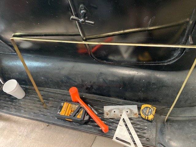

It is time to put the brass trim on the firewall. How to bend the pictured sold brass half oval at a 90 degree? I have read several places to do not heat it that it will break. I am thinking of just putting it into a vise and bending it, will that work? Is there a better way?

Use a Cut off wheel from the back side carefully removing the area for a 90 degree bend, heat and cool about 4 to 5 times, bend to your liking. Polish to perfection! DONE!

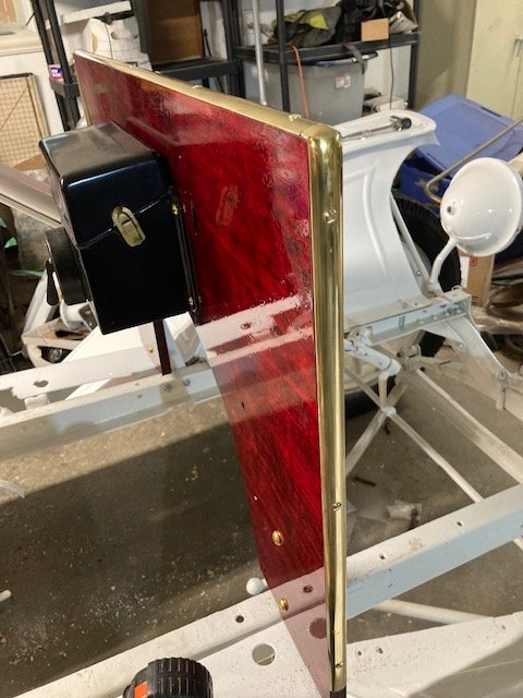

So I don't have a miter box but I do have a cut off wheel. I figured if I mess it up I would be able to salvage it and it WORKED! Looks really good too. Thanks for the tip. I did the flat screws on top and the round screws on the sides.

Very Nice Job!

Looks great. Wondering if you used heat or just cold bent it with that dead blow mallet?
Super looking.

Re: Advice for 90 degree bend on solid brass half oval?
I heated it cooled it 3 times before bending with a MAPP gas torch. I never saw it turn red. I just got it 'real hot'. I notched it once, bent the two parts together until they kissed then notched again to get to 90 degrees.
