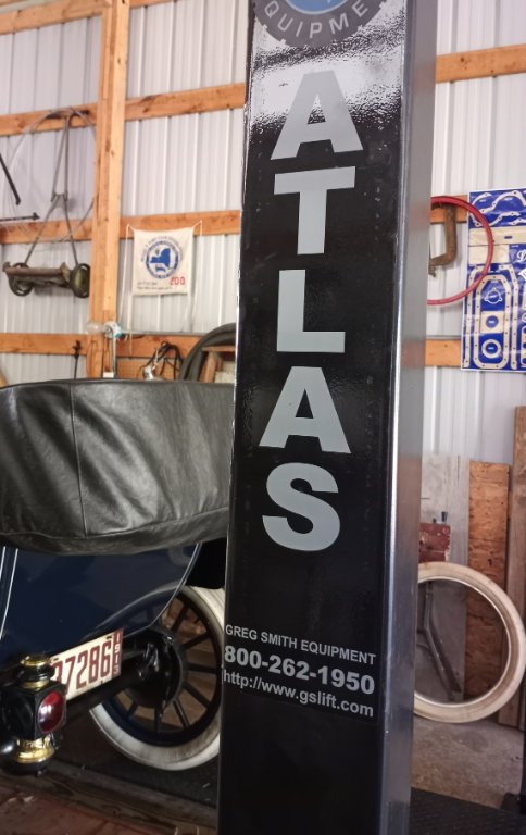

Here's mine. Yes its from China, but it seems real sturdy made, 8,000 lb. capacity, and Greg Smith Equipment has branches all over the country. Took me and a friend about 5 hours to put it together. I love it!

Well, scratch Greg Smith co. off the shopping list!  Permanently closed. Probly another casualty of Covid. Sum-b....!

ToolTopia.com has taken over Greg Smith Equipment. All sorts of types and capacities of lifts.

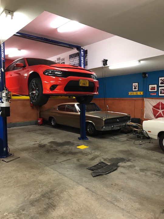

I have a Rotary two post.  I use it for all sorts of cars.  The 4 post is good for storing a car but it's hard to work on the suspension and tires.  There have been posts of people putting a T on a two post lift.
To find a company go to a local tire shop that's new or service station that's new. Ask them who installed their lifts. Chances are they will do yours.
They may offer used lifts. A good company will change all the components that go bad. Be careful if you buy a used one that has 1000's of lifts on it without changing the internals.

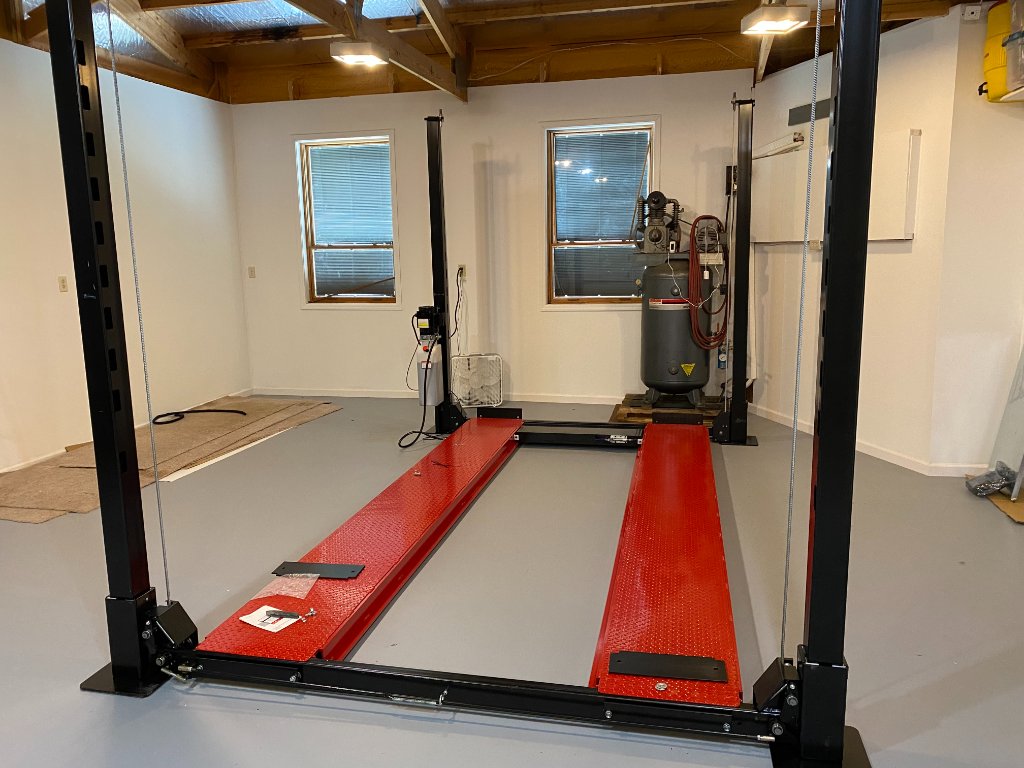

Hi Michael.  Like you, at 74 I'm tired of concrete and jack stands. I purchased a "Backyard Buddy from Advanage Lifts and am very happy with it. I wish I would had done it 15 years ago before the price hike last year.  I got the small footprint x-tra tall so I can stand upright underneath it and store another vehicle below. My max lift is 84 inches. It is American made steel. I checked a lot of other forums besides this one, Corvette, Classic Thunderbird and others and watched a dozen Youtube videos before I decided. I am happy with my purchase. I paid to have it assembled and it was well worth it. I purchased the casters and the sliding jack tray to go with it. I installed it in a pole barn with 10 foot ceilings and positioned it to go between the rafters so height is not a problem. A strong second choice was the Advantage lift, 9,000 pound lift with 5 inch columns. It is simpler and cheaper with more lift capacity then mine, a 7,000 pound lift. Their is lots to consider. Overall dimensions, ramp width, width between the ramps, maximum lift, etc. Shipping was a problem as my lift was in stock but with a shortage of truck drivers it took 3 weeks to get to Southwest Kansas from Dayton Ohio.  You can't go wrong with a Backyard Buddy or Advantage lift, with a few extras and assembly available.  My installer took his time and had it done in 4.5 hours.  At least I know it was done right.

Larry, interesting how similar in construction your lift, and others for that matter are, to mine. I suspect a lot of them are
made by the same mfg. with different labels slapped on them. Kind of like how Whirlpool mfg. near me in Clyde OH makes not only Whirlpool appliances but at least a half dozen others with various names.

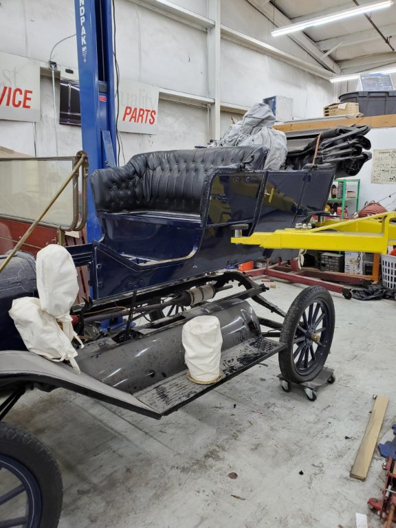

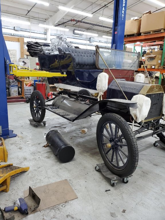

Our son came up with the idea for the procedure shown in these pictures.
My wife & I were out of town, and he texted us these two pictures. We'd struggled with "How do we raised the body enough to install a new fuel tank?", and he texted us these pictures.
