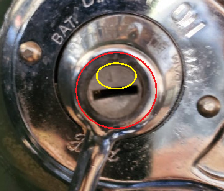

Current repro switches are chrome plated steel with plated handles but lack the Ford Script. Yours had Ford Script - could be a refurbished one. So take a magnet to it to see . The tumbler face looks original and a number does show looks like x1 could (51, 61 or 71).
NOW the reason the key fell out is likely that some of the wafers in the tumbler have fallen out, dropped out of the tumbler. When the key is removed the wafers drop a bit to prevent the tumbler from turning with an incorrect key. Some tumblers were designed to work with a guard so the wouldn't fall completely out see picture. There are also tumblers designed to limit wafer drop - these fit tightly in the guard and catch the sides of the square hole in the lock position. When a matching key is inserted in the tumbler it raises the wafers to clear the stops. My guess is that you need a new tumbler/key. If you can tun the switch with a screw driver tip in the key slot then that would confirm it. Now not all switches require removing the rivets to replace the tumbler.

I'll try again. The original tumbles had the corresponding key # stamped next to the key slot. Look closely. yellow oval, to see what it says -that's your key. The first number is limited to a 5, 6, or 7 (key number were 51-74) Now if you are able to turn the key slot without a key, any # key is likely to work. The original tumblers were made of pot meta which is known to deteriorate over time. My guess is that your tumbler is craked and the wafers dropped out. And I refurbish ignition switches in my spare time
