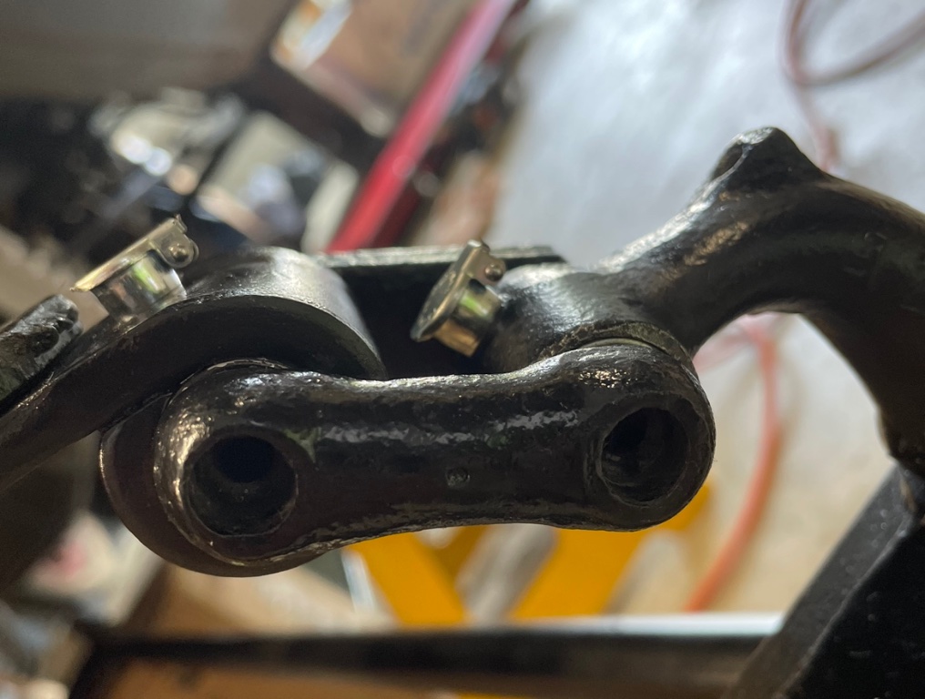

This is the front spring shackle. Should there be the gap where the red arrow is pointing?

Nope, at least not on my OEM Ford shackles. I suppose you could stack some washers or machine some bushings to fill the gap, then paint them black to help them blend in.
Or, maybe those are really rear shackles that have been mounted on the front? :)

That doesn't look right. Are the bushings loose in the spring eye and spring perch?

Those appear to be Model A rear shackles - are they tapped for a grease fitting ?

I'm with Steve. Those are Model A front shackles.

They don’t look to be tapped but no idea if they are for the rear. Have holes that look like they should have a great cap on front? Was thinking of buying new ones or using washers. I just installed new bushings and reamed them. Slides right in but too long.

We could buy off-the-shelf 2" long bronze bushes to suit T model front and rear shackles. A set of those could be left just long enough for that shackle to work well. Good original forged shackles are likely better than the repops available. Yours may not even be for a Ford, but they are likely better than others you will find.
