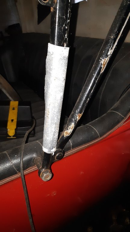

I went down in the basement (my workshop) and took some more detailed pictures. The ends are rounded, but center parts are square:
Here is my temporary repair:
and there are other suspicious places I need to look into before breaking apart eventually:
Ford Model T 1914 Touring

Post by Erik Johnson » Thu Sep 23, 2021 12:22 pm
Those are definitely 1918-22.
1915 -1917 are oval all the way up. Also, the first bow pin is inserted into the second bow eyelet from the inside, and there is a key/keeper on a leather strap screwed to the bow.
1918-22 are for the most part square/rectangular. The first bow pin is inserted into the second bow eyelet from the outside, and the wire keeper slides up and down on the bow as shown in your photos.

Post by Oldav8tor » Thu Sep 23, 2021 1:49 pm
My 1917 touring has oval bows. I fished the wood pieces out of them and poured liquid epoxy into the tubes both to prevent rust and to provide strength. You might consider something similar if your sockets are repairable.

Comments above about braze repairs showing. I haven't had an opportunity to really test this long-term yet? But on several braze repairs I have made over the years, I have coated the brass with plain Epoxy glue. Just a thin coat of simple clear Epoxy. The Epoxy sticks to the brass pretty well, and the paint adheres very well to the Epoxy. The one downside I notice, is the flow smoothness of the Epoxy can leave a "plastic" look to the finish. But a quick brush of medium sandpaper before painting helps with that. A good multiple coats of priming and sanding can make a really fine finish!
When I was working on, altering, repairing, and fixing, the top sockets for my 1915 runabout a year or two back, I had to 'fix' some low end rust through. That area is notorious for internal rust issues. Under the best of conditions, in normal use, water condensation and even direct rain can find it way in, and just the dampness sitting there (where the least paint ended up originally!) causes excessive rusting from the inside out. My top sockets were the wrong ones and not a matching set, altered to fit and look basically correct.
The mismatch sockets all looked solid, until I began heating and hammering on them. Then a couple of them revealed serious weakness in that critical area. One I managed to break completely off, another remained in place held by the remaining less rusty side. Both of them, I opened up the seam on the side, then brazed steel rods inside bridging the rust areas. I then filled in with a bit more brass, and closed the opened seam, brazing it back together. The finished sockets look pretty good, and should be at least as strong as they were when new.
