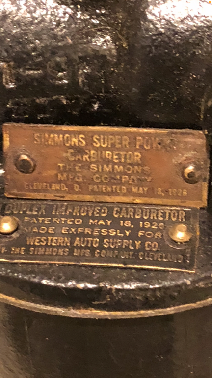

Many years ago I picked up a NOS simmons in Oregon. Has the same automotive test sticker on one side of the bowl & a simmons decal on the opposite side. No brass plate. I have another version in the cabinet with a brass tag like an NH, but says simmons. There is a third version called a duplex. All the same carb with the weighted flapper for the idle circuit. Nh needle/seat unit interchange. Jett & mixture needle are different to the NH.

Here is a picture of those ID tags.
