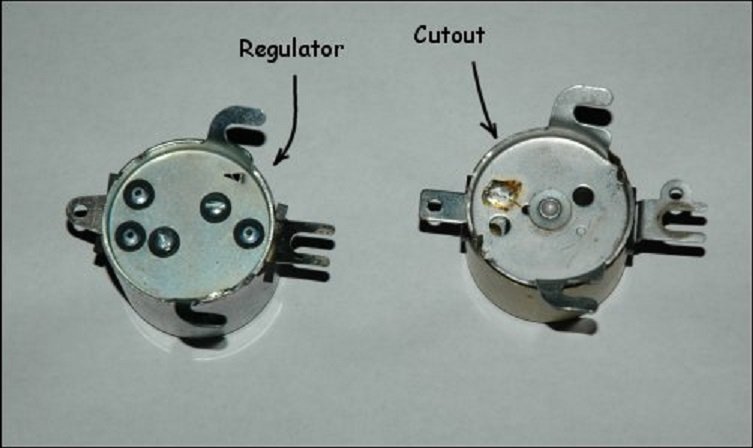

T gen motors when attaching pos lead to gen terminal and neg lead to housing. New fun products third brush plate and regulator cutout and no charge. Even ran a jumper across the cutout and still no charge. suggestions?

If you really have a FunProjects Voltage regulator installed and you "ran a jumper across the cutout" you no longer have a working voltage regulator.
That action will destroy the VR.

However, you say that you have "NEW" Fun Projects third brush plate and regulator cut-out - where/when did you get them. I don't see them for sale anywhere. Also t wouldn't hurt to verify that you have the regulator and not just a cut-out

Yes it is a SP regulator. I still do not get that if the gen will motor, why it does not charge..............
