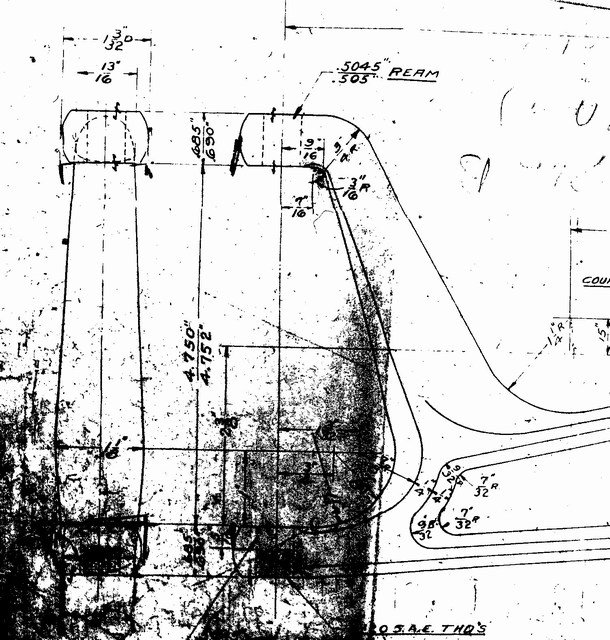

this pic, posted earlier is of the 09 front axle. Am needing the equivalent but for the later axle with room for the spindle arm hole. Help?

How much later axle?

This may be it, was posted on the forum before. Don't know the date, but the assembly drawing for it shows the spindle arm with the hole for speedo arm.
Note the greater distance (difficult to read on the print due to blot) to the lower yoke, from the center line of the spindle bolt, as the yoke is much different on this '11-'16 front axle. Assembly drawing below shows the clearance for the later spindle body with the removable arm.

Thanks Dan, that will work for me. J

Having a little difficulty reading part of the print, anyone have a cleaner copy?
