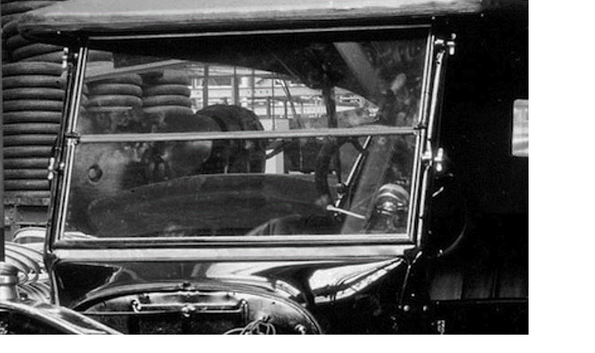

Last years Langs catalog front cover has a picture of a Canadian assembly line about 1925 which shows the Canadian windshield. You may do better by finding a complete Canadian windshield with frames and stanchions as some of your parts may not actually go together, or may not be Ford. Looking closely at the picture of your parts, the lower frame does not look like it is the right one, it is a different cross section shape and the studs are mounted with a different cone, and has a hand hold. I found this picture on the internet, misidentified as Hyland Park, but to my knowledge Hyland Park did not make export T's, notice the drivers door hinges and lower pivoting windshield.

Post by Mark Nunn » Fri Oct 01, 2021 8:03 am
Here is the windshield area of the photo above. This may help.

I see that the factory has wing nuts on the lower panel....mine has a clip for the side curtains fastened there. Is the lower panel supposed to open ?

Post by Humblej » Fri Oct 01, 2021 9:15 am
The lower windshield opens for Canadian made and export open slant windshield cars. USA made cars did not have an opening lower glass panel until the 1926-27 improved car.
