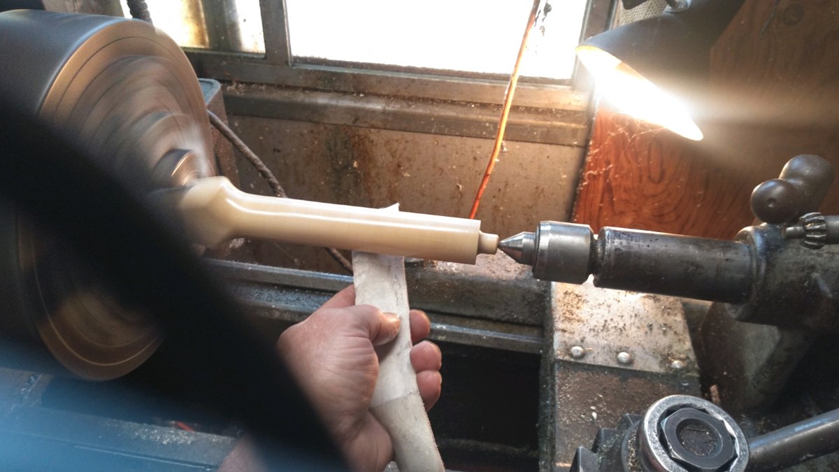

Re: Finish on new hickory spokes
Asking for Spoke Information, is like asking for what oil to use.. or if Electronic Ignitions are OK
Good information here..
viewtopic.php?f=2&t=21937
I used the Polly Urethane Gloss.. Four Coats.. Sanded the first coat with Paper in the Lathe.. The Other two coats got Fine Steel Wool in the Lathe. The Tenons Got hit with Coarse Steel Wool to get the 'Play-Dough' goop of the Urethane drips.
With the Final Coat Un-Treated except for the Coarse Wool on the Tenon..
On the TT I have, the Front Wheels were sent off to be 'Done by Others'. But when they come back, the Work Starts in Varnishing Them and Sanding while on the Wheel.. NOT Fun.. and the Varnish only lasts a few years Outdoors till it starts Flaking.. ( My T Lives outside )..
This next set of wheels I did on the '13 were Urethane.. I did not want the Owner (not me ) to have to Finish them in a few years.. And I did not want to sand them while on the Car..
I also did not like the Rotten Tenons on the Spokes I took off of the '13.. So I made sure to coat them with Urethane.. Then after the Stuff Dried I used the Steel Wool to get the shape back.
I coated the Spokes all over with Urethane, Even the mating surfaces.. Just made sure that the Surfaces were flat. I like my wood to be sealed as much as possible.
