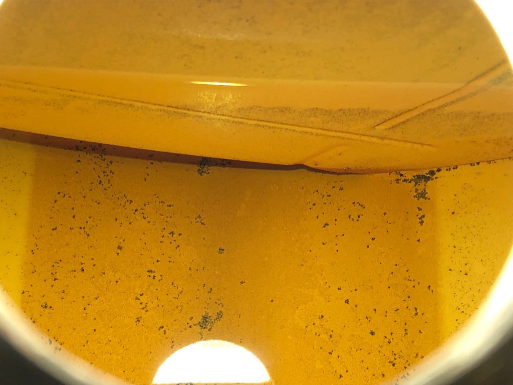

When I bought my '14 project the tank had been drained and the car stored for some time. I looked in the tank and it looked pretty good. After getting it running & driving, the NH started minor flooding. I could smell raw gas while driving and the motor felt like it was "fluffing" at low speeds. A newly rebuilt NH was installed and it did the same thing. A look inside the fuel tank showed that the situation had changed:
Now the tank I thought was clean had all sorts of rust bits inside. Something had to be done so I advertised for a new tank in the PARTS section of this list. I wanted a new tank so that I could install it in the car and have a minimum of down time. A fellow had a new tank setting on the shelf and we struck a deal to have it shipped to me.

The tank was indeed new but had been sitting for some time sealed with blue masking tape. The neck threads were rusty and the baffle showed rusty spots where it had been welded. Only a small portion of the inside can be seen and it seemed likely there was more rusty spots that were not visible.
