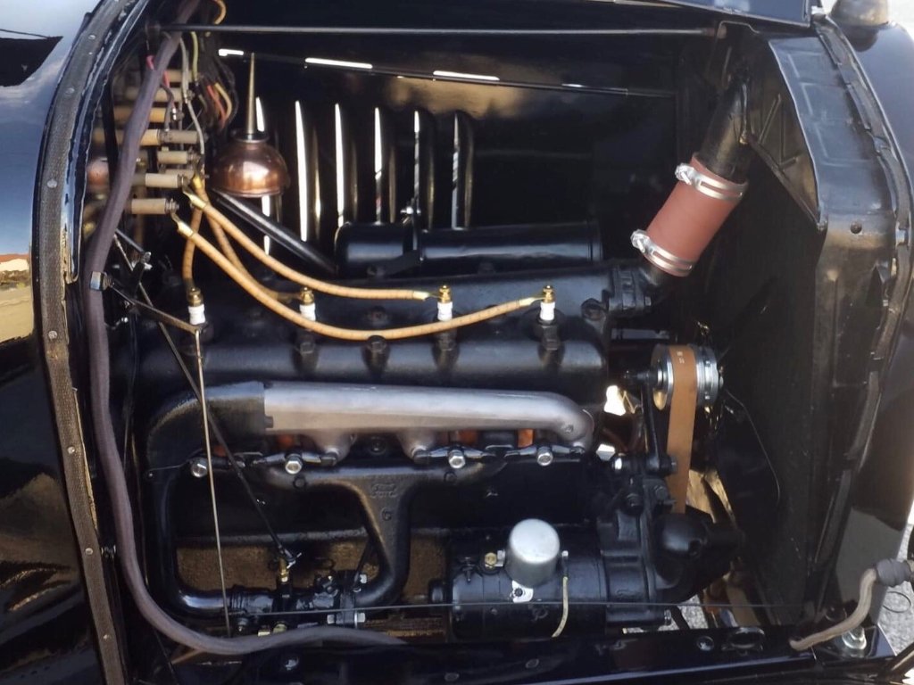

My coupe is titled as a 1925 and looks the part, the engine is stamped 10814734 and it has two valve covers. From what I read the serial number lines up with it being a ‘25, but what about the two piece valve cover?

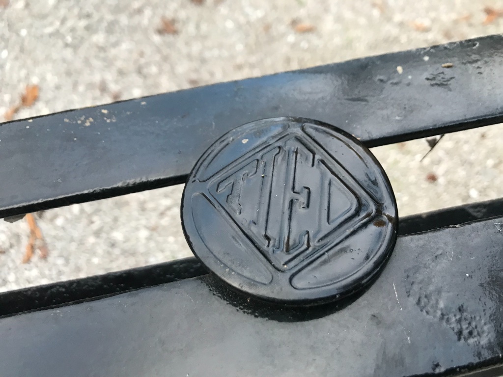

Also, when I bought the car it had this bumper installed on the rear, it has a manufacturer emblem in the center, “Tied”. Does anyone possess knowledge on this? My only guess is it’s just another aftermarket manufacturer.

Looks like a fresh re-stamp. Replaced the block & kept the #?

Your engine appears to be the early generator type with the 2  separate valve chambers that appeared in late 1919 and then changed in the 1922 models that had a single valve chamber till the end of T production.
If the engine no. is for the later style which a 25 would be it has been restamped to probably be the same as the title.
Lots of T’s had their engines changed through the years since for the most part they were alike and bolt in the same way. If it has a good title I wouldn’t worry about it.

The number font is not like any model T number I have seen. As others have pointed out, it is likely to be an earlier block with a later number stamped on it.

My crank pulley does not have flanges, and the fan has the longer type shaft. Does that sound like the motor is a 19-20?

If the serial numbers on the motor have been re-stamped the engine could be from multiple years and people changed out parts often because they were out of money or could not find anything locally so a lot of model T engines are slightly different than their year of manufacture.
Also, when an engine needed major work it was very common for a Ford dealership to take out the old engine and replace it with a rebuilt one right off of the shelf to save time.

The original crankshaft pulleys didn’t have flanges.  Over the years aftermarket crankshaft pulleys were  made from time to time and probably still are.  I have a couple of the older version flanged crankshaft pulleys.
The fan pulley looks like it’s one the newer ball bearing pulleys that have come out over the last few years. The original fan pulleys had a brass sleeve bushing in them. The ball bearing type is a definite improvement. They are avaliable from the parts suppliers.
Get yourself a Lang’s and Snyder’s parts catalog and you can see the newer version parts that are available . Some are a definite improvement and others are questionable but at least they are available. Lang’s a good selection of original parts and you can call to see what they have.
