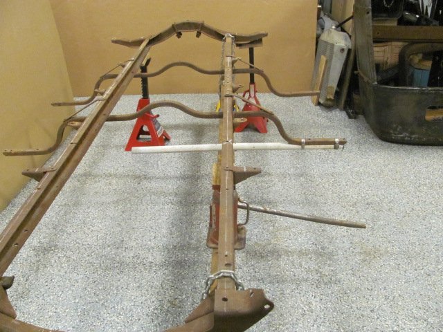

I will start with the frame.

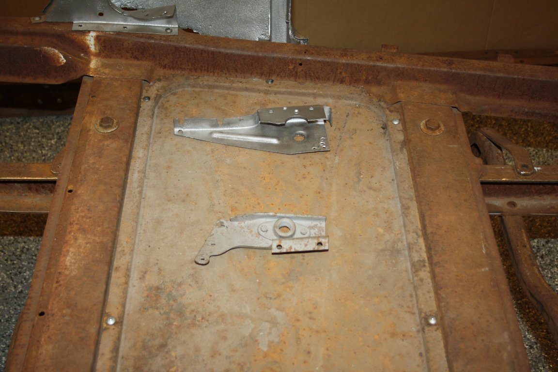

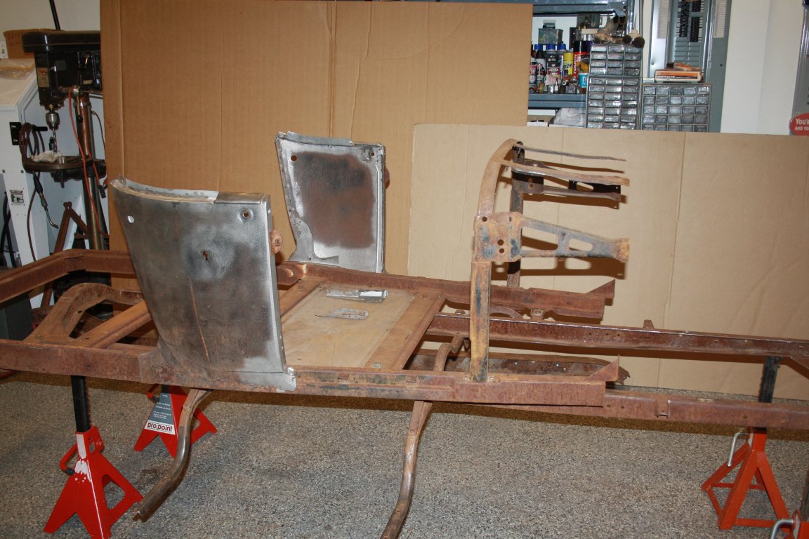

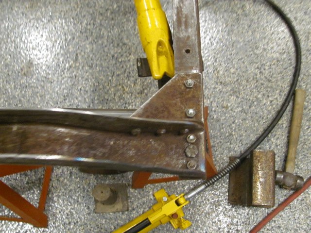

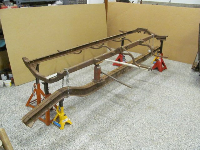

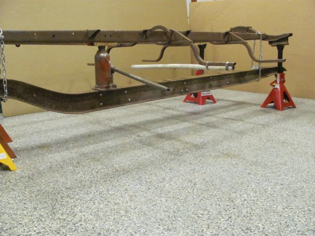

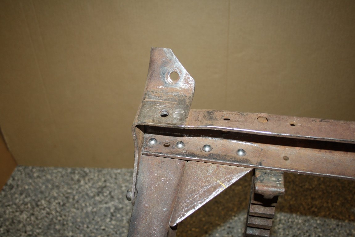

I set it up to be level and square. I discovered that it had been bumped in the right front corner and was out of square. I removed the distorted rivets because they were no longer a tight fit. I straightened and refit the bracket #2860B, and replaced the rivets with temporary bolts. Next was to push the frame to a relaxed square fit, and then tighten the temporary bolts. I then replaced the bolts with rivets one at a time.

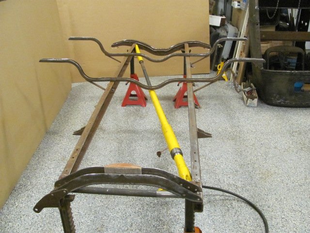

Image #10- The sub frame.

#12- With a small ball peen hammer, tighten the strap rivets.
#14- The cowl is often twisted, (evident in cowl skin cracking at the upper corner) so it is necessary to do a diagonal measurement and correct it to square. (tighten or replace all affected rivets)
#15- Hip panel braces. With the skin removed you can easily repair this area. After straightening or patching, spot weld the braces in and rivet the assembly to the sub frame and wrap the skin under as you do the cowl.

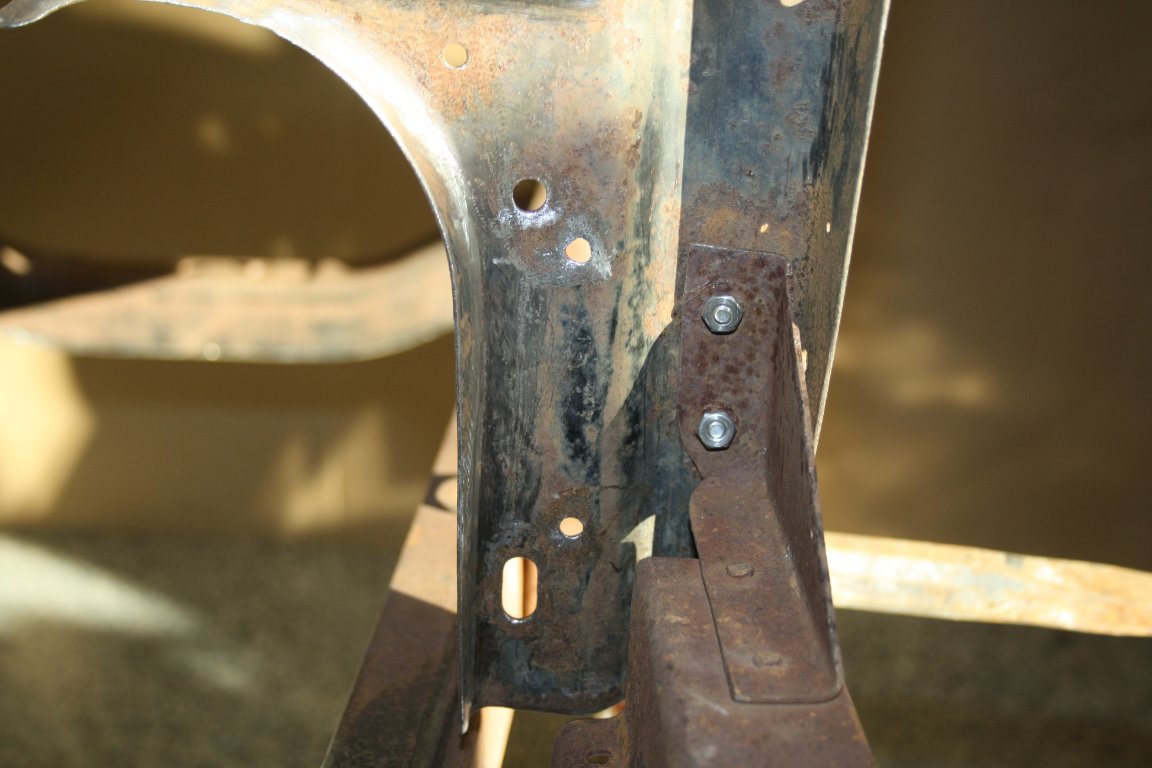

#18- IMPORTANT! leave this unbolted from the firewall bracket until the built body with fitting doors has been bolted to the frame. This is last because levering it up or down will change the door fit.
#19-20- Hold everything with small bolts while you build your car. Replace with rivets later.

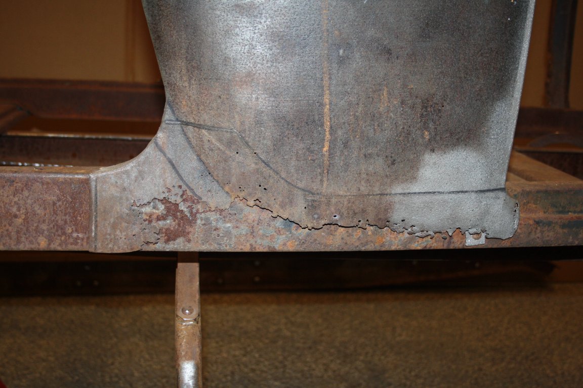

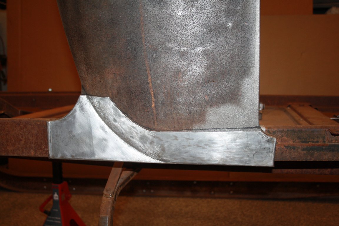

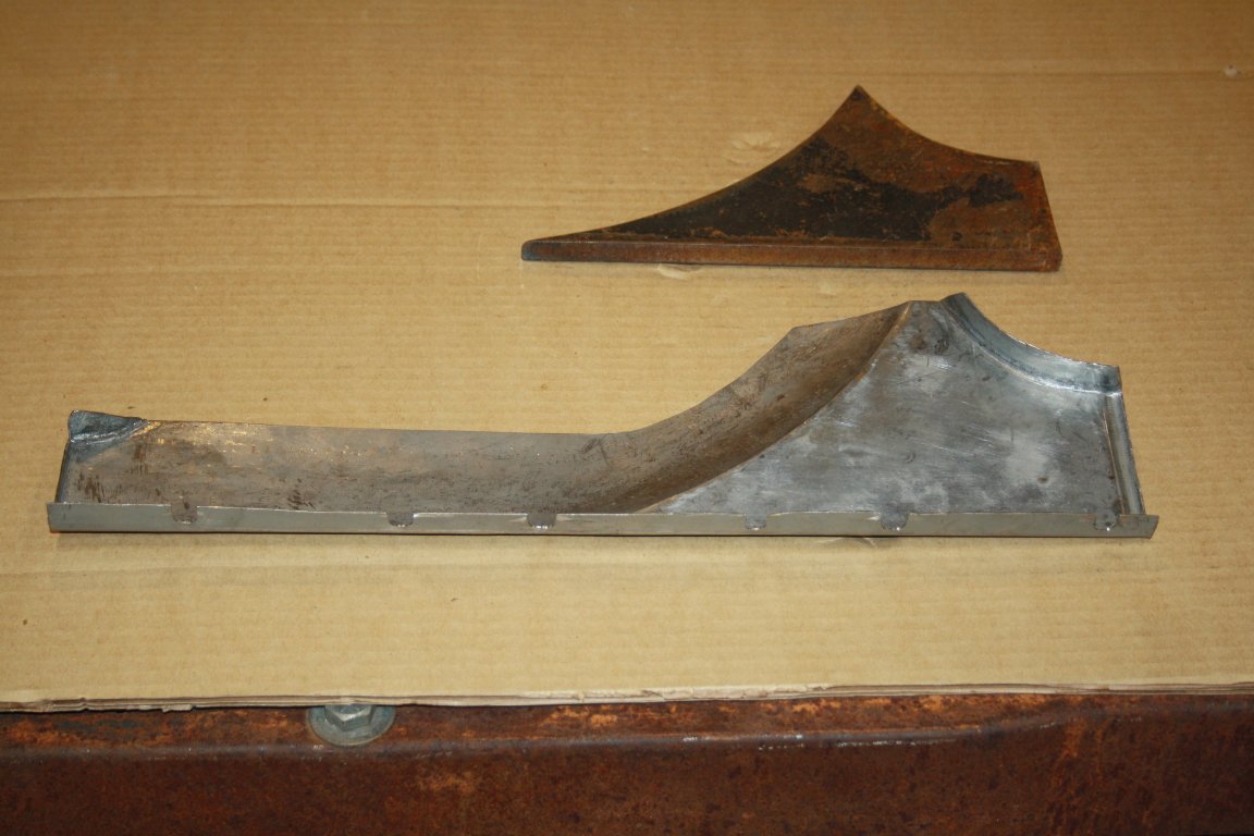

#21- You may want to buy bun panels from the vendors but I chose to form my own.
Work honestly
Stay true to your word
Get the job done right
Posts: 6725
Re: Improved Open Car Surgery And Build
Post by Scott_Conger » Mon Oct 25, 2021 5:30 pm
Ken...nice work on the panels! I have intimate knowledge of what it takes to make such a part, as I had to fabricate two of them for my earlier car. I had purchased the standard 26-27 bun panels only to find they were too far out for my purpose. It was my intro into a crash-course of metal bumping.

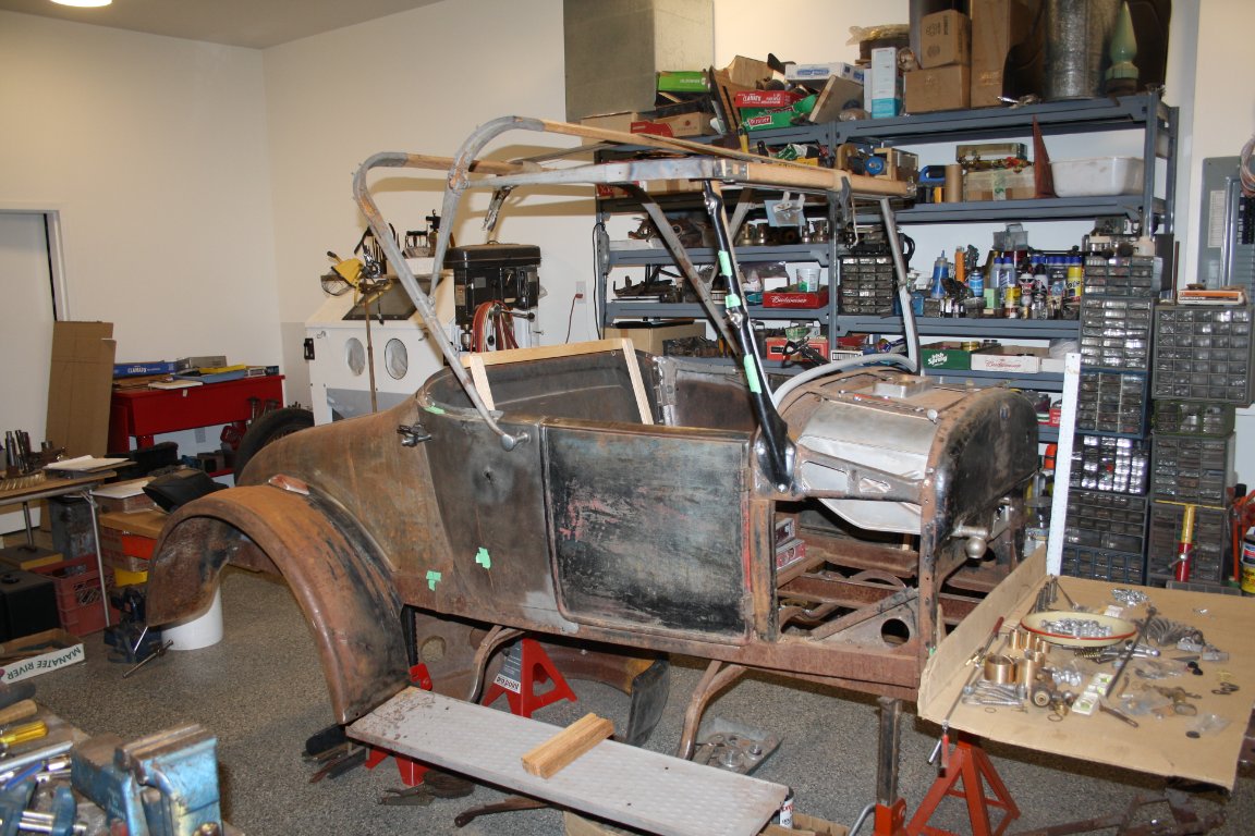

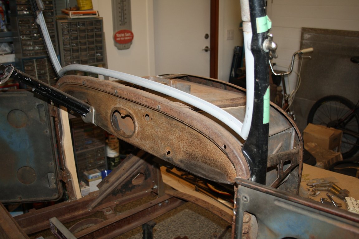

#28- A general look of the body structure. To avoid regret, pre fit and build the whole car before painting.
#29- The windshield post nut surfaces and the door hinge outer surfaces are plumb.

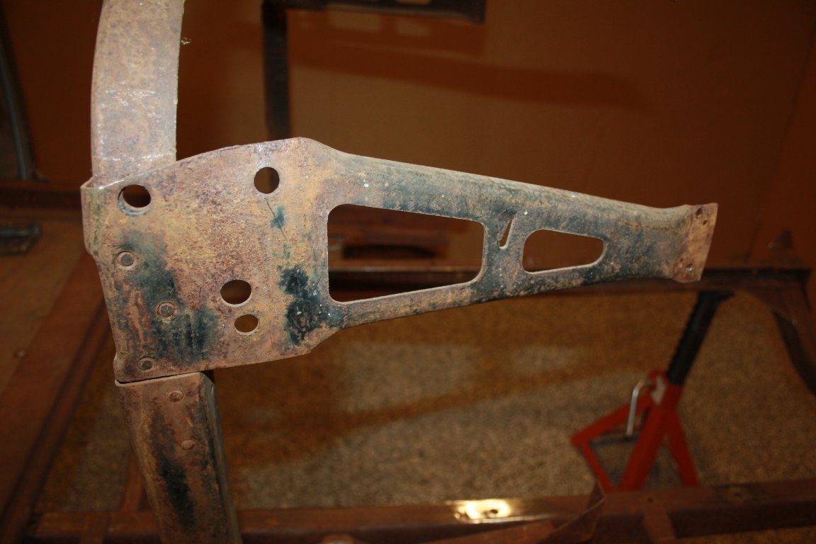

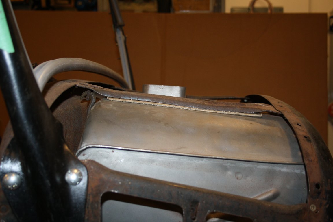

#30- With the cowl structure exposed, you can access the upper braces if they have sagged or have been dented down. The tank strap hanger brackets bend forward with tension from tightening and the car bouncing. Bend the tank strap brackets slightly rearward so that the straps can be installed with the tank in place. You now have access to the split rivets that hold the webbing above the tank and you can hold the tank in place with one hand while tightening the straps with the other. Fitting the forward tank pad/cardboard is a breeze.

#32- The straight edge shows that the forward face of the roof bow aligns with the center of the door hinges.
#33 & #34 show a closeup of the braces with a cardboard spacer where the webbing goes.
