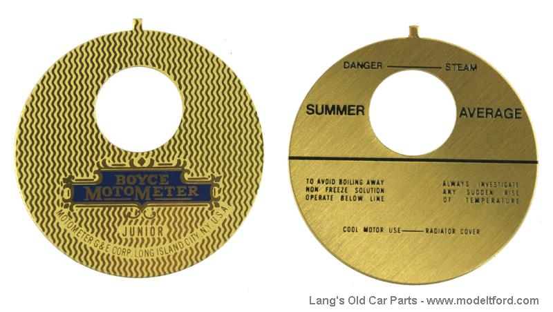

Re: Lower extension for a Moto Meter.
Mark is on the mark....
Motometer reads water vapor temp inside the upper tank area.
Info from the horse's mouth

Have you considered that the Moto Meter may have been designed and calibrated to be a steam gauge not a water temperature gauge? Note the position of the sensor bulb in the radiator neck. The patent text 1090776 https://patents.google.com/patent/US1090776MichaelPawelek wrote: ↑Fri Nov 05, 2021 1:47 pmHas anyone added a coil of copper wire or a spring to the bottom of their Moto meter so it actually extends into the radiator water and registers properly?
The 24 Coupe I’m working on now has a flat tube radiator and cools so well that the water level never comes up high enough to touch the Moto meter and I just don’t get a decent reading. The meter works fine dipping the lower part into hot water on the stove so I know the problem does not lie there. Thanks
the protuberance 24 and-within the air s ace or' pocket 36 formed in tl ie'inlet 20- and -the upper part of the 'radiatorabove the level '0 the waterwi thin-the radiator/I, the bulb. being protected against fracture or breakage bg athimble orcap 37 formed of metal or t e tuberance 24 and providedwith a plurality of apertures or holes 38 as-shown in Fig.. 3.. It will beapparent-from"the-'foregoin that the bulb of the thermometer-'31, extend ing'into' the airspace 36 will cause the inso dicating fluid, which may bealcohol, glycerin,'or any other suitable medium which will retain. its homogeneity or solidity -regardless of the vibration of the system of which it is apart, to respond to changes-in the'temperature of the atmosphere within the air space 36, whichis inpr'bximity to the point-{of inflow 19st the heated water com-- ing fronrthecylinder jackets -The; plate 32 to which th'e'thermometer 40' is secured is ositioned to. the rear thereof, its front face eing provided with the
By John Berch on Wednesday, December 21, 2011 - 04:41 pm:
The original Moto Meters are a steam gauge and are calibrated to operate that way.
I don't know anything about the new reproduction Moto Meters, so I can't comment on them. I don't know what they use in the thermometer on the repops but the originals were Glycerin and alcohol.
The reason for the stem not being submerged in coolant was intentional. I would think any modifications to imitate a submerged condition would alter the reading intended, at least in the lower reading and might insulate it, slowing reaction time of the meter. Boyce's theory was that the air in the radiator tank above the coolant could be as much as 30 to 50 degrees cooler than the coolant itself. If boiling occurs this changes very quickly as the steam from an overheat condition sends the red column into the danger zone very quickly. The meter is calibrated to show a low reading for operating temp and to show a spike in the sight glass when boiling. Operating temperature is very close to boiling so on a submerged thermometer your gauge would register very high all the time with very little movement as it moved in to the boiling range.
There is no temperature value in degrees just a relative indication of the cooling system functioning properly.
