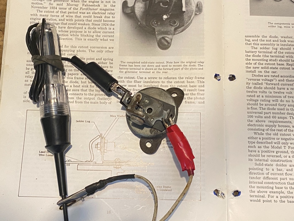

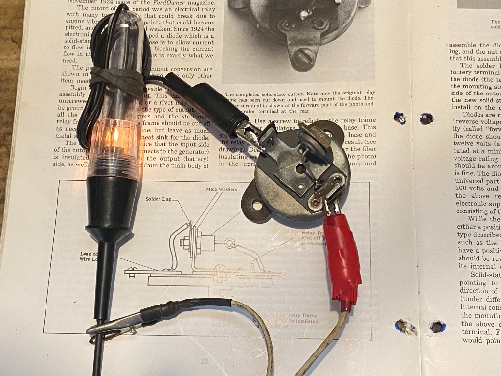

I’ve been checking out a few miscellaneous cutouts that have accumulated over the years, and was surprised to find a diode in one of them.
I think this one is actually set up for positive ground… I can’t see a polarity indicator on the diode, but current flows when the input terminal is connected to 6-vt Neg and the output is connected to 6-vt Pos. Conversely, the test light is dark when input is 6-vt Pos and output is 6-vt Neg.
So, which wires are crossed… the ones in the cutout or the ones in my brain?

Thanks for your replies, Pat, and I understand the basic goal: allow current to flow from the generator to battery (assuming sufficient voltage differential) but not the reverse.
My roadblock is in interpreting the test results. Intuitively, I assumed (there's that word) that when the generator terminal is connected to positive and the battery terminal to negative, this mimics the installed situation, yet my test light does not illuminate. Hence, my concern that this diode cutout is set up for a positive ground car.

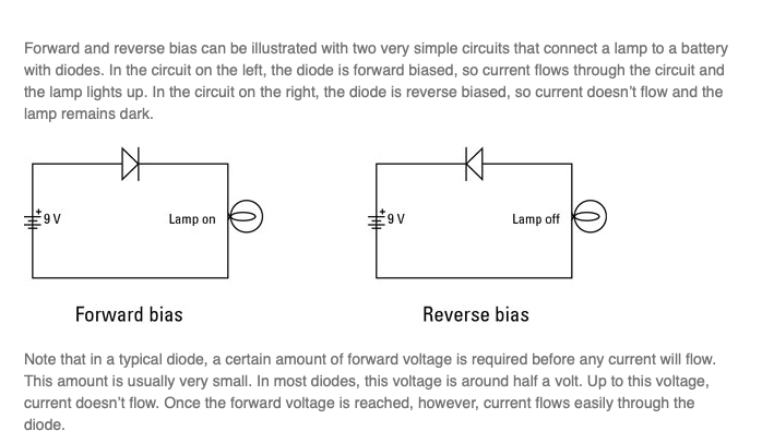

The graphic below is from Electronics for Dummies, and to this layman, seems to support my guess that this particular cut-out is actually wired for a positive-ground car.
And that is my question: is this cut-out wired for a positive or negative ground car?

The diagram is correct. You might want to see if there's a part number on the diode - if so you could look that up online and it would answer your question directly.
Otherwise if your generator is negative ground (as in a Model T) it will be outputting +VE on its terminal and you'd want the cutout to operate when that's applied to its input.
However bear in mind that while the Model T was negative earth the Model A was positive earth, and it can use a similar cutout. In that instance you'd want the cutout to operate when -VE is applied to its input terminal. If this is what you have it's likely from a Model A.
