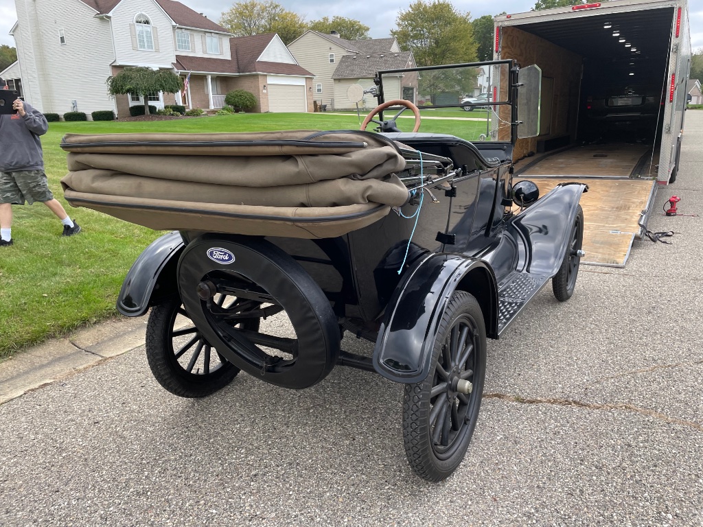

I borrowed a top boot cover from a friend to give to my upholstery person to have her make me one out of sailboat fabric. I want to use it until I get my top installed to cover the top bows both for aesthetics and to prevent damage while towing the car on an open trailer.
My question - there were a couple of long straps attached to the top of the cover but for the life of me I can't see where they would attach to the car. No buckles, hooks, snaps, footman loops, etc. Can someone enlighten me?
The photo shows the strap hanging over the front of the cover and dangling down the back of the car. You'll see it really is quite long.

Those long straps on the vendor made top boot is to secure the boot top side to the rear seat.
Remove the lower rear seat cushion, the pull the boot taunt and pull those straps down flush with the rear seat backrest.
Then replace the rear seat cushion, that will pull those straps down and secure so the wind won't lift the boot top like a sail.

Dan - would they hold with no weight on the seat going down the road at 70 on an open trailer?
- Posts: 3953
Re: Touring Top Boot
See strap with red line
For securing the straps for hauling, I used fasteners on the straps, put Lift the Dot screw bases into the wood tack strip at the lower part of the rear back rest. Then fitted Lift the Dots to the fabric strip, that holds the strips now nice and tight for eliminating the risk of the top cover lifting.
Then, I wrap bungee cords over and around the top boot too, that prevents the boot from leaving the T and flying off the open trailer!

The boot does not have to be the same fabric as the top, but it does feel correct if it is. When the boot is on you cannot see the top anyways.
I would not drive 70mph on an open trailer. Even going 50, air gets under the boot and lifts it up. You could put something like a bungee cord all the way around the boot to help hold it down.
My boot was made by Cartouche and works fine. It has three straps attached to the front top of the boot. They have snaps on them, so I lift the seat and attach them to the board that is under the seat. They are the same snaps you find on a pair of jeans.
I also have the same murphy fasteners on the side that John has. Makes it a lot easier to install the boot over the top. I also have the shoestring on the bottom of the boot to help tighten the boot over the top.
I am not concerned with authenticity. I am not a trailer queen. I want a boot that works.
