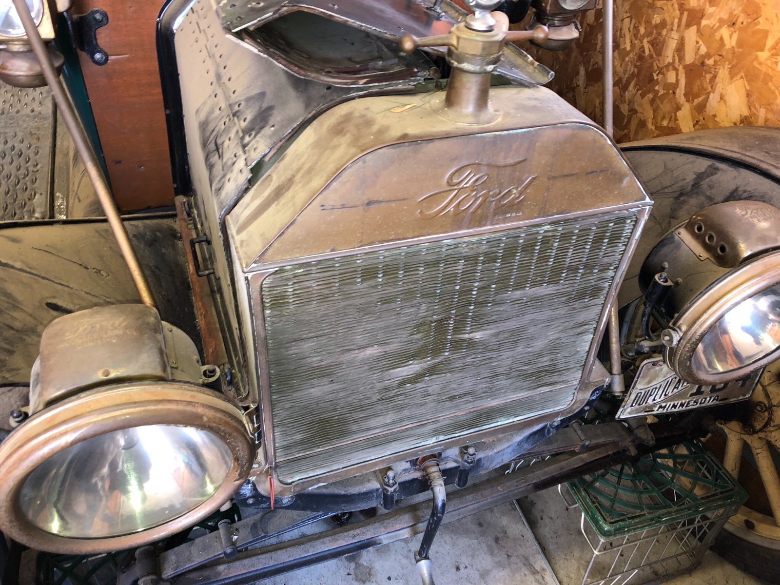

Post by Jeff Perkins » Wed Mar 27, 2019 8:42 am
Is this a Victor #1 lamp? Lamp body is black, top is brass plated steel. I have never seen one of these.

A side view would have been nice. My '13 touring came with those lamps. I think they are ugly, and chose not to use them. The tops were not brass plated steel that I'm aware of, but could have been. If I were to use them, I would brass plate the tops. All of the Victor #1 lamps are scarce, and they made two styles of tailamps, square and round. A photo of the round one I saved is pictured in Bruce's book.

I thought this may be the 1913 Victor lamp mentioned in Bruce’s book that he did not have a picture of. Here is the only other picture I have, when I get the car home I would be happy to send you more pictures.

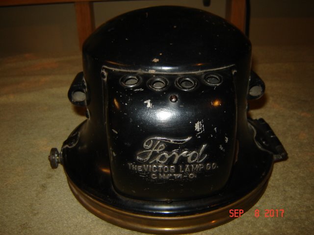

I have three of the victer #1 headlights. None of them show any evidence of brass plating on the chimney which of course does not prove they were or were not not. I also have a pair of #1 side lights and 1 each of both styles tail lites

This is a NOS Victor #1, or used very little. It shows no indication of brass plating on the steel bonnet.

Wow pre15...! You REALLY have one of the incredibly elusive Victor #1 square tail lamps with the 4 ‘foldovers’restraining the brass chimney top with embossed script?.. how blessed you are ....and with matching cowl lamps too??

Thanks for posting that photo. They are around, but scarce. Donna Jones in Sebastopol has a pair of them on her '14 roadster. Kim Dobbins has a pair of them also. I saw a photo in the La Jolla history museum a few years back that showed a '13 touring with those lamps. It's the only photo of a '13 I've seen with those lamps.

In 2008, at the Big "T" Party in Indiana, there was a pair of Victor #1's in the swap meet that had solid brass bonnets, not plated.

Yep Victor model 1, very early one had Brass bonnets then all steel through 13,
