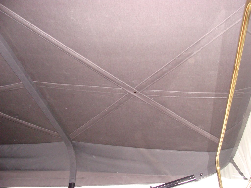

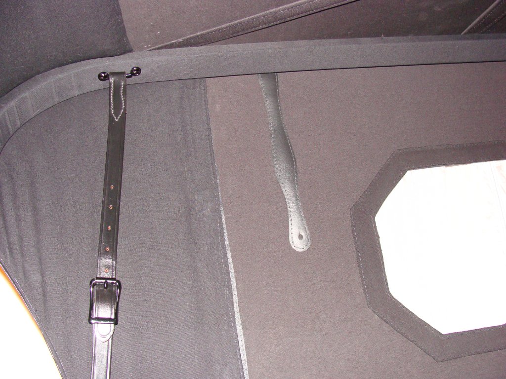

Does anyone have a picture of the straps that go on top of the top bows? Mike at Classtique made me a set and I would like to see how they go before I remove the deck. Thanks.

Re: 1911 top
Here is another picture showing the black rivet where the straps cross. Art

Thank you Art. That was exactly what I was looking for. When I Talked with Mike at Hershey, I asked for a set for a set of straps like he had made for you.

Art knows his stuff. Everything looks right.

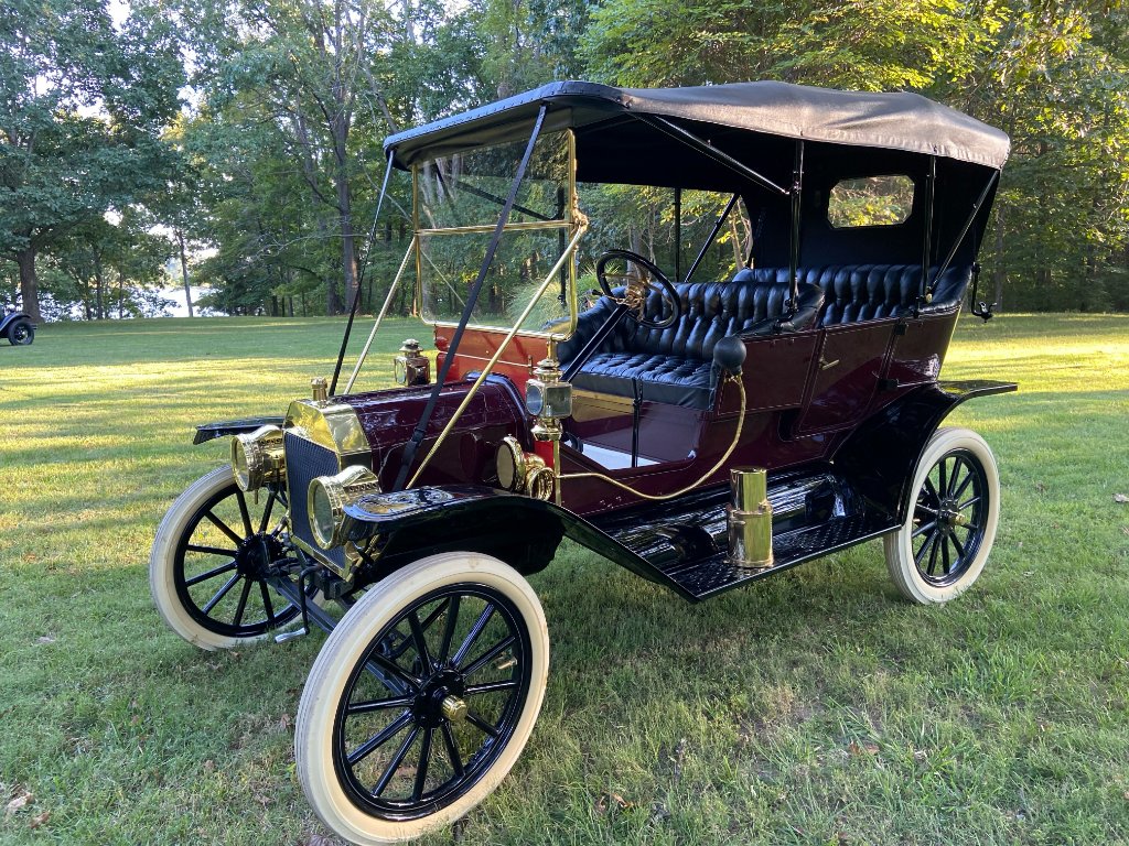

The important part is the bow alignment.
Here is my car: Here are the dimensions I used: These measurements are in a straight line, from the center of the pivot points to the ends
Unlike later cars, bows #2 and #3 are about the same height.
When the bows are down, #1 and #4 should match up and #2 and #3 should match up.
Here is a diagram chock full of information that you will need to print out and study: All these measurements is very tedious work. When you get frustrated, take a break. Have a friend help you hold parts together as you measure.
C-Clamps, ratchet straps, and lath are your friends.
Keith
Keith
- Posts: 4455
Re: 1911 top
All great advice!KWTownsend wrote: ↑Thu Dec 02, 2021 11:57 amThe important part is the bow alignment.
Here is my car:
1911 top irons.pdf
Keith
I'll add 1 more suggestion.
- When fitting the various top components, there is the tendancy to pull each piece taught. Who wants a saggy top? However, with free standing top bows, (i.e. not rigidly attached to the windshield frame, as with later T's), the additive effect of pulling each element taught may tend to pull the top bows off location and also result in the bow pads & straps hanging loose once the topping has been installed. Whenever you add pieces for the next step in the process, stand back and look at your previous work to see if it's still in proper form. (Also, always do your work with the car parked on a flat & level surface. A body twist while installing a top will result in a skewed top when the car is moved to a flat surface.)
