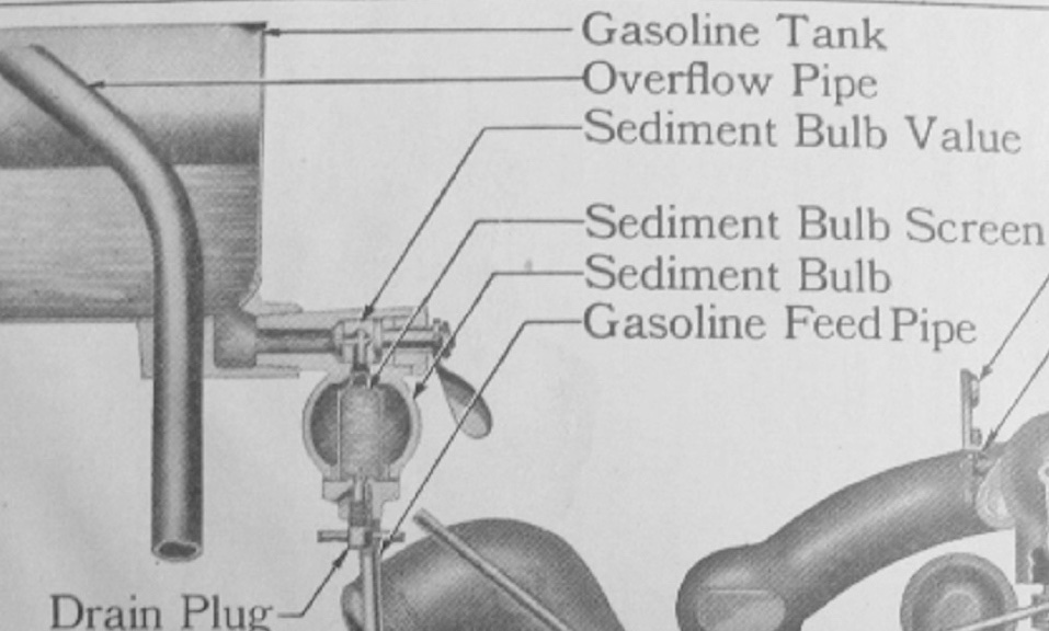

Bryant
Posts: 1214
First Name: Bryant
Last Name: Shafer
Location: Myersville Maryland
Re: Sediment bowl broken off in my '26 gas tank
Post by Bryant » Wed Dec 08, 2021 7:29 am
Also beware of the drill bit or ez out length. You don’t want to accidentally go thru the back of the tank.

Bruce Compton
Posts: 670
Joined: Thu Jan 10, 2019 11:23 am
First Name: Bruce
Last Name: Compton
* REQUIRED* Type and Year of Model Ts owned: 1921 Coupe, 1925 Coupe
Location: Kemptville
Post by Bruce Compton » Wed Dec 08, 2021 9:53 am
Bryant: Thanks for posting that picture as It clears up some concerns I had. Again, thanks to all that contributed ideas, once again demonstrating the quality and value of this great site. Bruce
