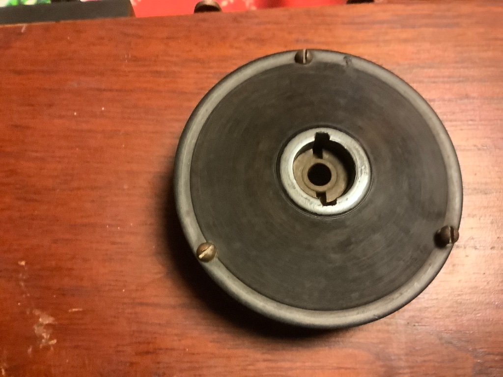

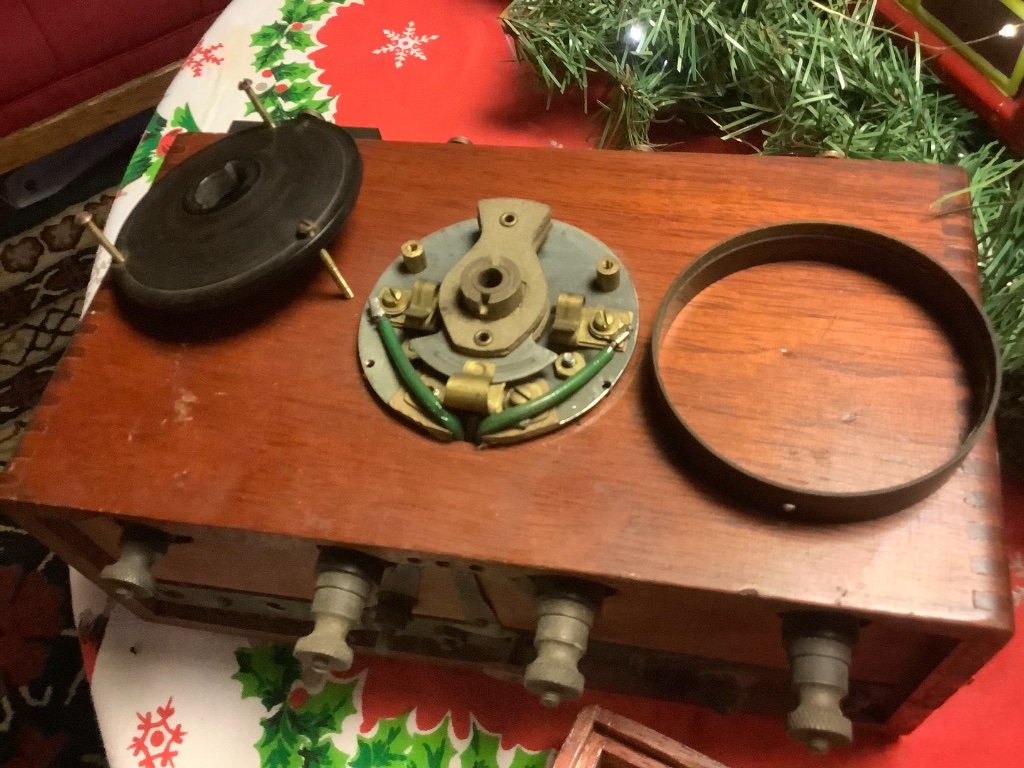

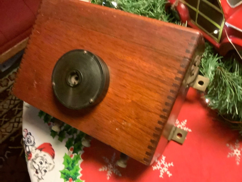

I’m stumped with this one. Background is it’s from a very old antique autoists estate.   Obviously NOS throughout.  Just as pristine as an item can ever be found nowadays, with original shellac finish overall, and great patina on the metal parts.  Uses a later Key to operate the switch. The switch housing is old timey Gutta Percha, or more likely bakelight.  Switch housing shows a handmade but very professional machines finish, not something molded.  The rest overall shows a very professional construction.
My uneducated guesses are a very early prototype K-W coilbox, or something era aftermarket or pirated. I cannot see a name, marking, cartouche anywhere, but then I may not be looking in the right place. Any thoughts or ideas are welcome.

The craftsmanship of the box looks to good to be a survivor or even a restoration. The switch mechanism is the same used in the 1914-22 boxes with a different backing plate. The dovetails on the coil unit and box are different size than that of older coil unit pictures. Many of the old coil units were dovetailed top & bottom not the sides. The  thickness of the black top plate is also much thicker than those in the old pictures as well.

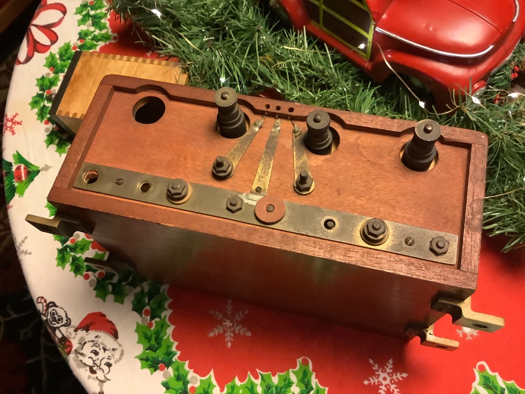

Thanks for the thoughts, Frank. Keep ‘em coming.  I’m doing a couple more pics, but can say , from my decades of antique repair and refinishing, this box is absolutely very old, but in really pristine condition. Unused condition. I sure don’t know it’s it’s 100+ years old, but it is NOT contemporary, 50-60 years old.   Some pics and more thoughts on the way.

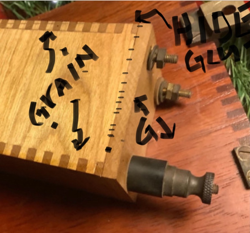

Re: Help identifying this wood coil box ??
Note the coil construction.  The box jointed  case has a bottom that has been glued on with hide glue, and they have shrunk because of the cross grain situation. The glue has let loose on this joint only.  Hide glue is unmistakable, when bottoms were taken off.   ALSO, note the light  scribe line on the box joints. This likely wouldn’t have been done or used on a mass produced item.

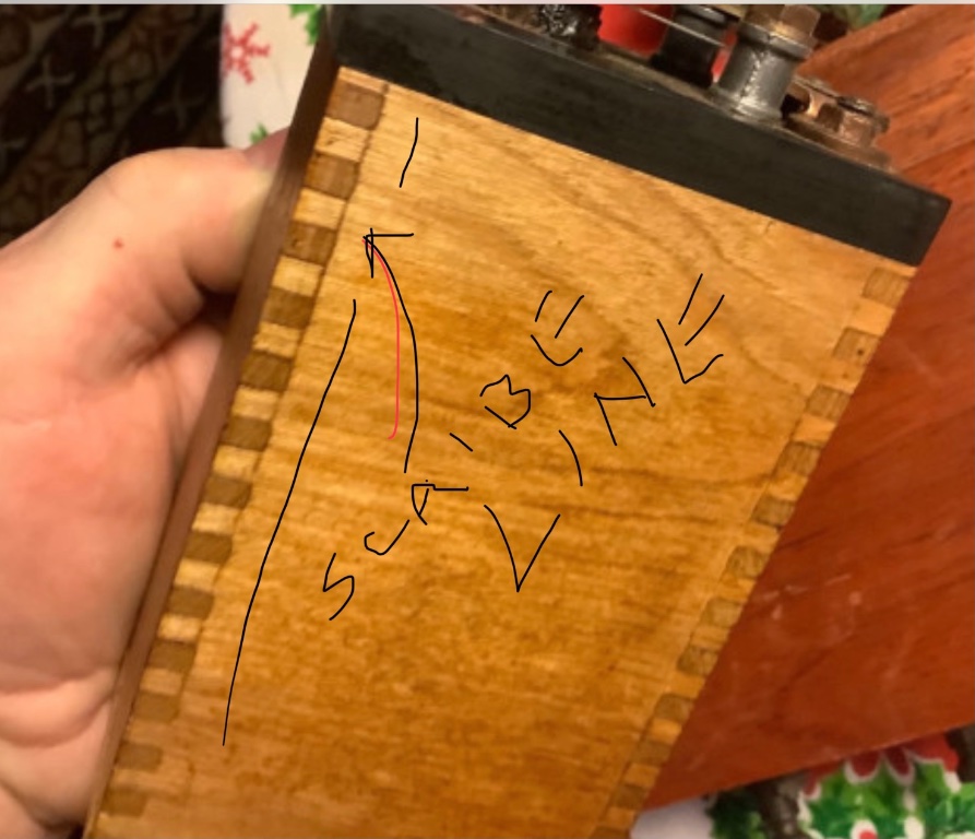

Light scribe lines on box jointed coils.   Sanded away on some before shellacking

Tim-
The bottom of the coilbox looks like the Heinze type that was used on the Model R. (Not sure about N and S) The contacts come through the bottom of the box instead of through the dash, like on the Model T.
As Frank pointed out, the switch looks like it has the guts of a '14-'22 KW coilbox.
The points are clearly KW type, '14-'27.
I know only a little about the NRSK fords. However my guess is that someone was restoring a Model R (or N or S?) and made a reproduction coilbox and coils based on the original construction, but used later T parts, switch, points, etc. The coils may even have KW primaries and secondaries in them. I think the restorer used the resources he had at hand to replicate the entire assembly that would look good and get his car down the road. Since it is in pristine condition, I speculate that the restorer eventually found an original coilbox and coils to use on the car.
Of course Heinz made coils for different automobile manufacturers too, so it might not be for a Ford!
