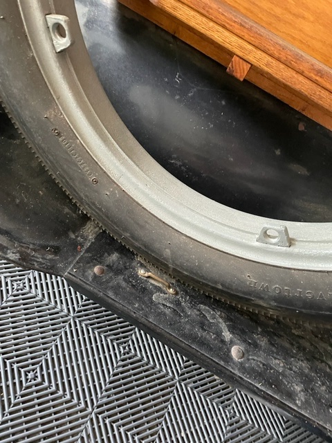

Not saying it’s pretty or even close…but it sure is extremely functional.
Footman loops on running board…out of view ‘stud’ on the Post that would otherwise be hinged pillar. Rides fine n steady

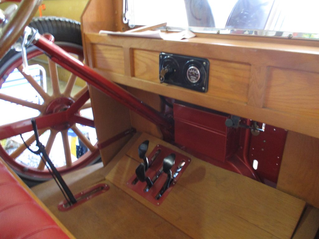

This is the way it was done on My 1920 depot hack. two spare wheels and tires complete with hubs and spindles are used as a driver and passenger doors. good for photo ops but not real functional as a door. wheel and tire too heavy. I leave passenger wheel/door off. too big a hassle to deal with on a regular basics. 2 # 1 photos can't figure how how to delete one without messing them all up.
