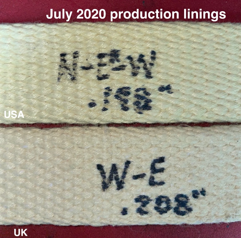

The email I sent merely stated that installation on his steel bands was available at $10 per band. As far as comparing material, I believe Nev-R-Wear to be a superior product to that which is imported from England. I had that product forced on me from a previous supplier and rejected it. My Nev-R-Wear linings are made in the USA and have a 100% money back guarantee. If for ANY reason the end user is dissatisfied, send them back. The point that should be mentioned is that the ends of our bands are NOT sealed. Engineers at Dupont warned us over 25 years ago that the only product that would not cause deterioration in the Kevlar fibers was an epoxy that would harden and possibly cause damage to the steel drums. If the end user chooses to seal the ends of the bands, that is their business, but I do not want to accept the liability if something should happen to your transmission.

The latest NevRWear is what used last time, and will use again, but to be honest, have yet to replace any Kevlar linings due to wear. Oh, while maybe others don't, but I coat the very tip ends of the NevRWear with a dab of gel-type crazy glue, to prevent fluffing, had that happen before and like to seal ends of the lining, they overhang the lugs anyway, harmless to the drums, its just the same material used for skin glue!That brings up another question. Has anybody compared the three current makes and found differences causing them to prefer one over the others?
Will be pulling bands from my '27 in the spring, and do a check on them, will be able to approx. the miles and time from install, that may give me an insight.
As for comparison, have used the made in England and the USA, and prefer the USA type. The weave is a bit finer, and lining is thinner, and they flex better on install, seem to be flexy like cotton.
The England weave is different, thicker linings, and have a compressed weave look, and because of that are quite stiff in comparison. Perhaps the compressed weave is better for wear? Perhaps the flex weave is better for oil saturation? Can't comment, just visual observations.
