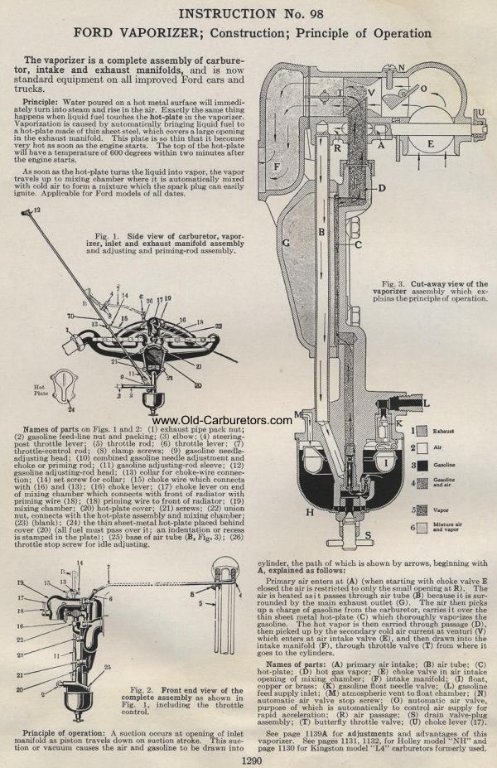

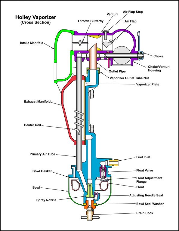

Vaporizer Rebuild http://www.mtfca.com/discus/messages/82 ... 1529609068
The following diagrams are explained in the link above
