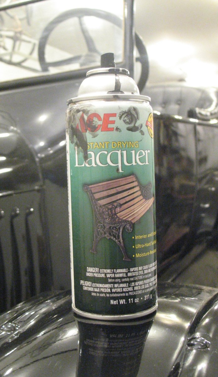

- Posts: 7347
Re: Best Black Paint For Painting a T?
...unfortunately lacquer is close to unattainable
I bought this at the local hardware store.
Recently I replaced modern carriage bolts with correct ones and had to touch up the windshield stanchions. I'll see how the lacquer holds up.

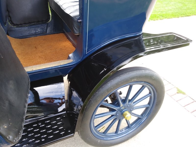

Due to what I perceive to be a victim of "adult A.D.D." and the accompanying short attention span, I only skimmed a
few replies. So FWIW, here's two pics of what I painted on my former '12 touring (splash apron and a fender), I used PPG Concept DCC9300, with the appropriate hardener and reducer and a small can of something to give it that "wet look", which half the time you don't really need! This paint is not cheap, but really goes and flows well! But of course prep is paramount as I've learned the hard way. I sprayed these parts (also some not pictured) using merely a Preval glass bottle/aerosol unit, typically found at any local parts store for around $8. Thinning to the right
consistency is critical, trial and error will show you.
