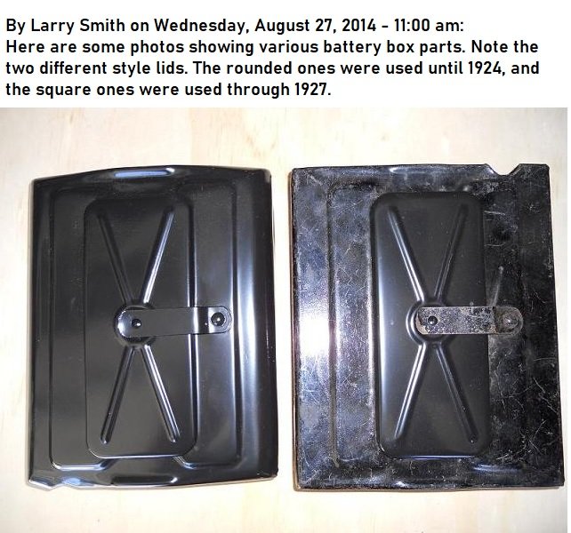

It sure looks like an original 1925-up lid to me, but Larry Smith is the expert. :)
Posts: 6581
Re: BATTERY BOX LID -- ORIGINAL ?? -- WHAT YEARS USED ??
Post by TRDxB2 » Sat Jan 01, 2022 1:26 pm
Here are some photos showing various battery box parts. Note the two different style lids. The rounded ones were used until 1924, and the square ones were used through 1927.
Good link for differences
http://www.mtfca.com/discus/messages/41 ... 1409322400
http://www.mtfca.com/discus/messages/50 ... 1438553141
I'm sure there are other differences for an original vs a repo lid but this is the most obvious

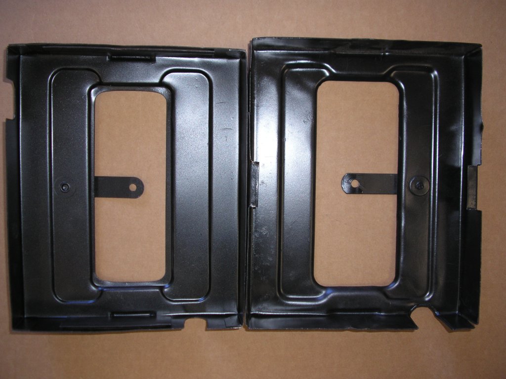

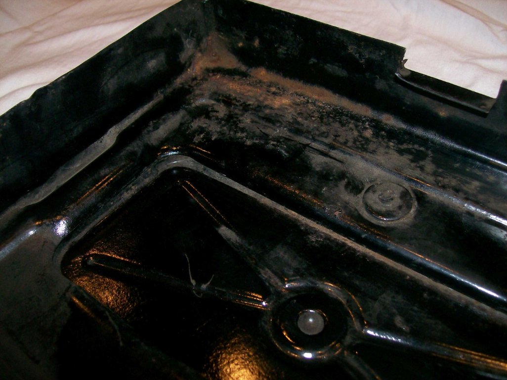

Here is a couple pics of a reproduction lid. In the first one, the impression is not as pronounced in a original. In the second pic there is a metal strip jogged and spotwelded to the lid. This takes the place of the handles or the plywood spacer otherwise used. This was a better idea for sure as long as the spotwelds held.

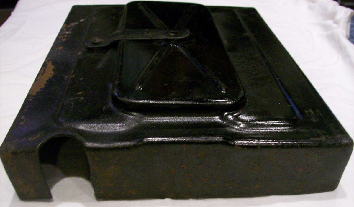

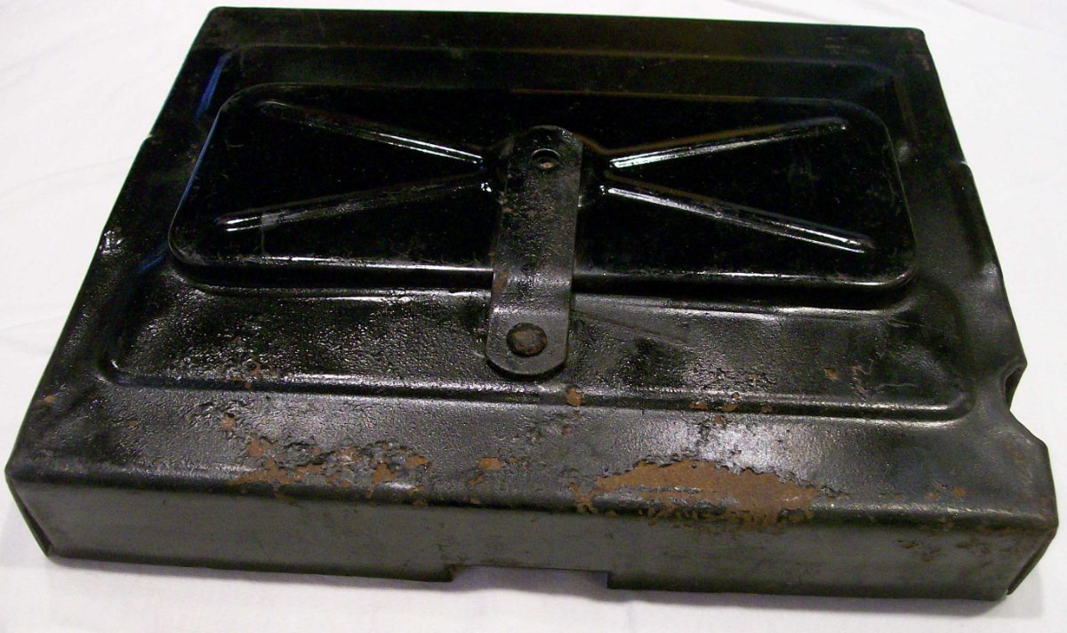

This one is in very good condition, I think everything is original..

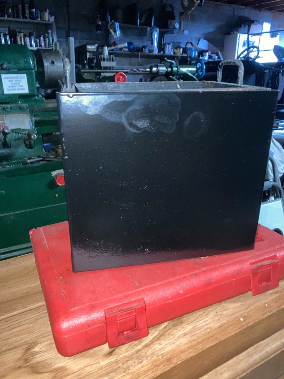

According to the Ford Battery Manual, the wooden box with the two metal handles is the battery case. The cells were assembled within this item. It's equivalent is the later molded, hard rubber case. Confusion occurs when the case is called a battery box. I believe the battery box is the tin box that Larry has reproduced.

Allan, I’d say that would be correct on the wooden part being the battery case. The original wooden case Shown above fits perfectly into my …original? Battery box

Here is another issue. The reproduction lid measures 7 1/2 X 9 1/16, the original lid is 7 5/8 X 9 1/2. The box measurements were posted on this forum long time ago were 7 1/2 X 9 3/8. As you can see below, a reproduction lid will not fit a box made to those measurements. Reproduction lid on the left.
Posts: 3950
Location: Lomita, California
Post by Original Smith » Tue Jan 04, 2022 11:28 am
Thanks Don for posting that. I always wondered about it. Why would anyone go to the trouble of making something incorrectly?
