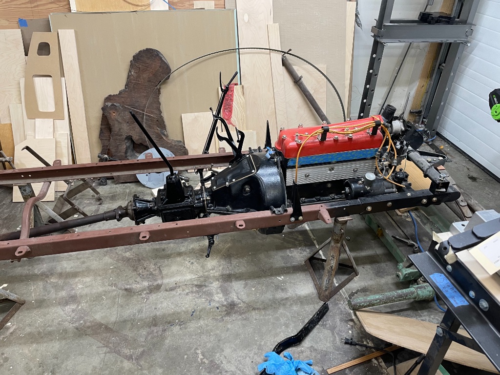

Well, it’s a speedster, so the point is to “improve” the T and make it faster. I have a Muncie auxiliary transmission so I will have Rocky Mountain Brakes. I have never thought of the wheel falling off when the axle breaks as a feature, but I guess it would bring you to a stop eventually. But wouldn’t you still loose your brakes if that happened?
Back in the 20s, they made a much more robust ball bearing system to support the differential for use in race cars and speedsters, but it included an entirely new differential housing. Sadly no longer available.
This is hardly the most challenging problem I have faced building my car and I will get it worked out.
