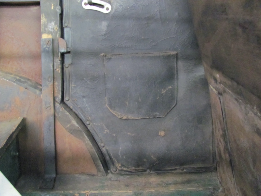

During my restoration of my front door, one suggested if such pockets couldn't be reproduced.

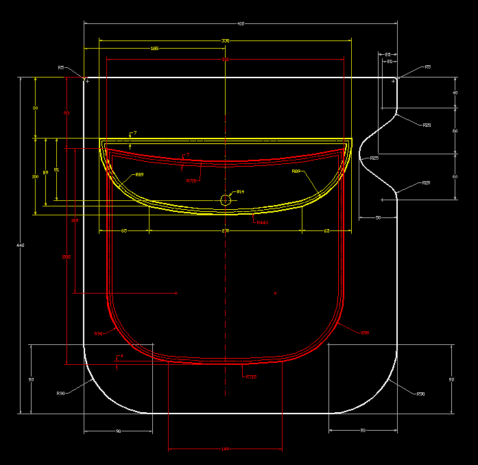

I want to contribute. As I was confirmed by »Humblej« in another thread, my door pocket appears to be an original one (100+ years old), so I took detailed measurements and made a technical drawing before I glue it to the 1.5 mm plywood (= cardboard replacement). Gluing it to thin plywood will give it the necessary stability because the textile inside this artificial leather is very limited. So if one wants to reproduce them, at least the dimensions are not lost.
Here a link to the ZIP file (I have no idea if such file can be uploaded here):
http://www.hantsch.co.at/_Model-T/Front-Door-Pocket.zip
The drawing is available as AutoCAD R14 .dwg file. All dimensions are in Millimeters, the drawing is made in Millimeter Units. (So one can easily open it and pick all dimensions also in imperial, if desired.) I also converted it into PDF format and added it to the same .zip file, so one can open and print it without needing a compatible CAD program.
I have placed each part on a separate layer (also in different color) to make it easy to turn visibility of each part on and off.
Front-Door-Pocket - Drawing preview
Humblej was so kind and showed me this "Western Auto Supply 1928" catalog page. The shape of all parts (back material, lid and pocket) of my door pocket differs a bit, as you can see ... Especially the radius below the door latch is extremely different. The catalog shows a radius of estimated 50mm, while my door has a radius of approx 90mm. Also the pocket lid has different shape.

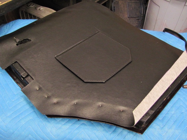

I added a new tool pouch to the door on the '27 touring, to carry sunglasses or whatever. Except it really doesn't open up enough to reach to the bottom, since the bag is attached to the door panel, and can only slightly expand one direction, as the bag sides are sewn flat.
On this aftermarket Model T body, the two rear doors had 'flaps' that open to store items inside the door compartment, very roomy way to haul tools or other stuff! Made sure to replicate these flaps when redoing the upholstery./b]

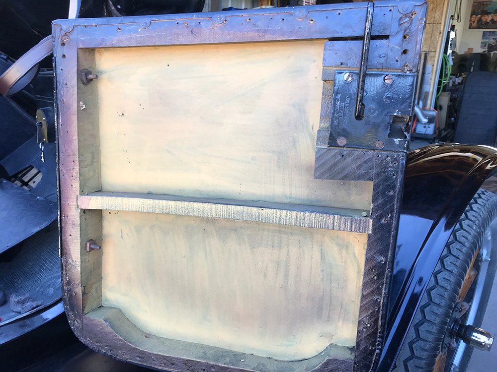

The attached picture is of the right front door of my 1917 Touring. You will see that the only places to tack a pocket would be to the edges or the bar across the middle. I would think if you really wanted to secure it your best bet would be to remove the panel and sew the pocket to it.

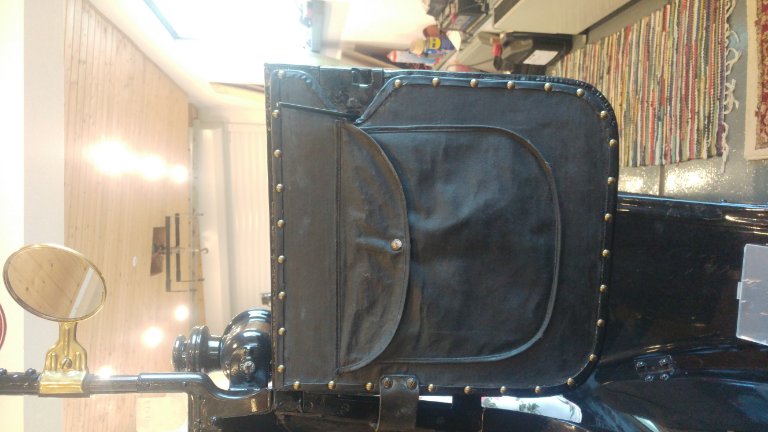

Right now I finished the restoration of my front door, so I want to post a final picture.
Finished door
Finished door
I think I will not paint the tacks black, this decent brass looks nice.
What I did was gluing the original door pocket to a sheet of model-airplane plywood (thickness 1.5 mm), using a permanently elastic PU glue. The plywood was protected first by several layers of parquet paint. The edges are covered by a stripe of new "artificial leather" to hide the extremely bad edges of the door pocket. Because sewing does not work through plywood (at least I don't want to ruin a sewing machine), I glued the ribbon to the edges.
Now the door looks lots better but still matches the overall look of my Lizzy.
