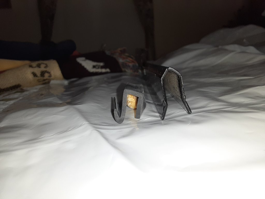

I ordered 8020CH (metal channel) and 8020 (rubber seal) on page 205 of Lang's catalog. These are shown in the attached photos. I had not looked closely at them until today. The rubber seal has a lip that is to prevent water from getting inside the door. The glass from my coupe is also shown.
I had assumed the rubber seal fits onto the glass and then the glass is inserted into the channel. I now believe this will not work. There is just not enough space in the channel as can be seen in the one photo.
Has anyone used the rubber seal?
Can I just use glass setting tape and forget trying to seal out water?

The new channel and the seal you have are the wrong parts for your car.
It looks like your old glass channel is in good shape and can be reused with new glass.
If you give the old window with the glass and channel still together to the glass guy he should be able to take it apart and reuse the old channel to install the new glass.
I cannot find the rubber weatherstrip in Snyders Antique Auto Parts catalog, it may not be available anymore. I am not using a weatherstrip as I did not give it to the glass guy when he installed the glass in the channel and now it is too late.
This is a no brainer, just give the old glass window with the channel to an automotive glass shop and let him take care of it.
Really, let the glass guy do this.
I am serious, give it to the glass guy to do.
