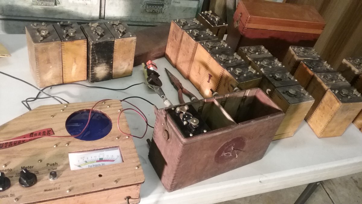

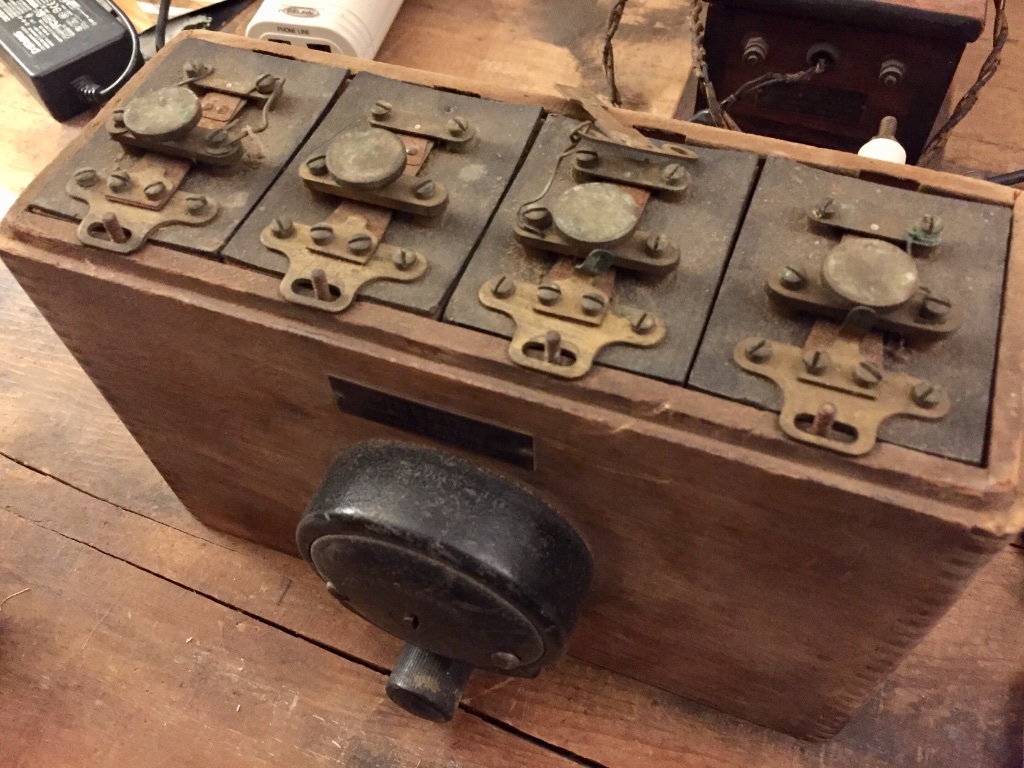

A friend asked me to look at his 1913 coil box. I was having a difficult time finding him any information for testing and rebuilding.
For starters is it correct assume that the test points would be on the same place as the later coils?
What should I expect the secondary resistance to be?
Thanks!
Matt
Thanks!
Matt

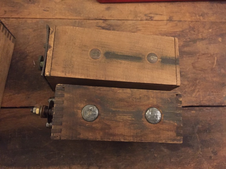

The coils boxes are in immaculate shape! Unfortunately, three seem to have opens on the secondary when I read with the ohm meter. The third one reads 3.89k ohms.
On the top of the coils someone shorted out the contacts. These must have been used with a modern aftermarket ignition. Could that have killed them? Or perhaps they were ran without a spark gap? That would have been a unfortunate mistake!!!
These are similar in size to modern coils. So I could see how they could be great candidates for a new coil. I look forward to additional insight!
Matt

Matt , that same 'shorting' of the points was necessary when running an aftermarket original master vibrator, not an uncommon occurrence on early cars.

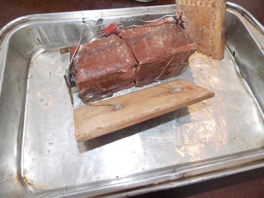

The coils you have there are late 1910 and 1911 Kingston coils.
The bridge wire, on top, between the contact point was for using a Master Vibrator Coil, as Allan from down under said.
The resitant of the high tention coil should be 3.5K to 3.8K Ohm.
Rebuilding these coils is not that easy. To do it right you should take them totaly apart. I did it a few times with the good advice of late R.V. Anderson. We will miss him. I hope that the parts he made will stay available.
To take them apart, you must first heat the finger joints with a paint stripper, pay attention do not burn them. The heat will melt the glue.
You will find a brown-red block with in it the coils and de condensor.
I replaced it with good coils out of Ford coils with a bad box.
The low tentions need to be cut for a few mm. There for just pull two or three turns on each wire on the underside of the coil. For the condersor I used the condensor offered by Snyders but Langs should do also the job.
Replace the contact points with new and give the other hardwear a good cleaning.

I was able to test this coil even before cleaning the points. Since they don’t have any cushion spring, I am not sure how I would remedy the double spark. Perhaps a double spark is a feature on these coils?!?
I measured the capacitance to be .33 uF. If these haven’t been rebuilt I think it’s quite amazing.
Thanks again MTFCA!
Matt

Andre/Matt: Thanks for posting this, it's a great read from both a technical and historical perspective. I learned a lot from reading your posts. I wish Vintage Ford would do an article on this topic or at least include more technical/historical articles in the publication.
You got to love that Strobospark, and Matt, that coil testing module is cool too. Keystone Cranked Coil Tester, better register the KCCT trademark before someone else snaps it up! Respectfully, jb

I don't disagree with you. In my research I am now interested in looking up the articles mentioned in the thread linked in my last post. Namely: The Vintage Ford's 3-part series entitled "The Model T Ignition Coil" by Trent Boggess and Ron Patterson (Vol. 34, Number 4). It seems like a updated reprint of this series would be very electrifying.jab35 wrote: ↑Thu Jan 27, 2022 9:38 amAndre/Matt: Thanks for posting this, it's a great read from both a technical and historical perspective. I learned a lot from reading your posts. I wish Vintage Ford would do an article on this topic or at least include more technical/historical articles in the publication.
Actually James, this coil tester does have a name FACT. See the following thread for more info: viewtopic.php?t=9072
The FACT is very handy. I have shared the designs and am happy to help anyone wanting to make/use it. I don't think there is a better tester I could have connected to these coils. No, I am not looking for money for it. Just helping people in the hobby.
Matt

Andre,
With your encouragement I decided to open the box. The boxes are in amazing shape- like they were made a year ago! I have open to many of the boxes of the newer quails and they are much easier. The glue on these I still need to figure out how to heat it as you suggested.
Thanks!
Matt
Thanks!
Matt

Re: 1913 Keystone Kokomo Electric coils information request
Matt,
You are on the right way.
I use paint stripper heat air gun, but pay attention not to burn the wood and take your time to open the box one piece at the time.
If some of the panels like to stay togheter just leave them. You just need to take out the coils and work inside the box.
Good luck
Andre
