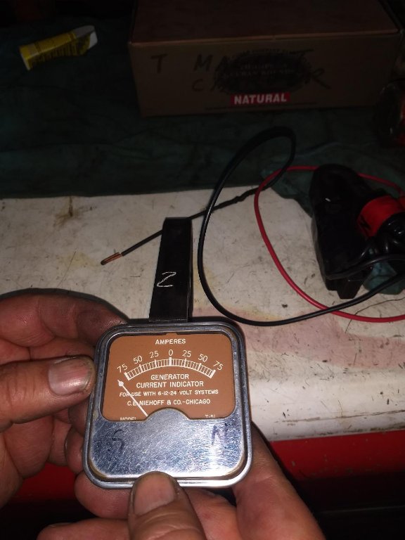

#! magnet fully charged. meter reference

Magnet with max charge using a fixed core type charger touched to magnet ends.
In addition. 1 of the magnets in the pile didnt pass the ring test. Thud. I beat on it & it wouldnt break. I noticed it was rougher & thinner like not enough material when it was rolled out. Gave it a charge. It would not take a "full" charge. It would not hold the 4# sledge & gave a similar meter read as #3 magnet above. Defective. It will not be used.
