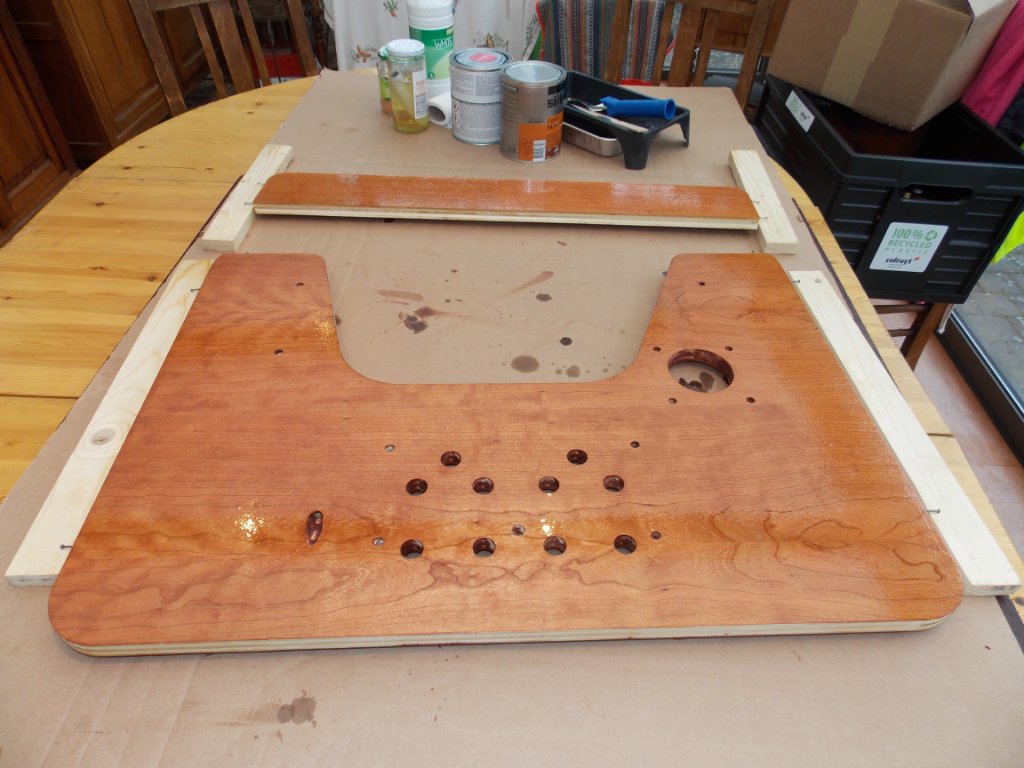

In the fire wall, on the car they are three bolt to attach the support on the fire wall.

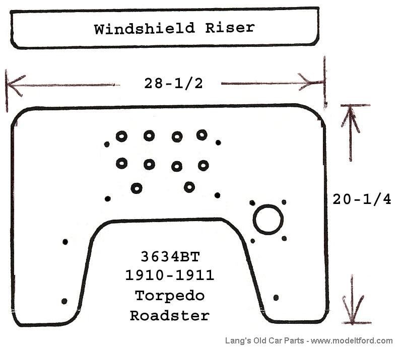

On the fire wall, I ordered, there are only two holes to fix the fire wall. The drawing shows the same.

Fire wall plan.
Fire wall plan.

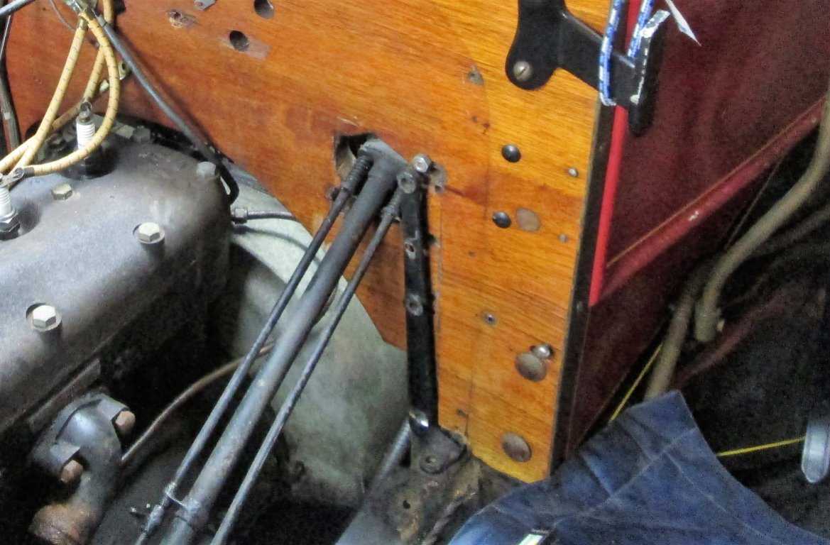

The fire wall on the car.
The new fire wall I get.

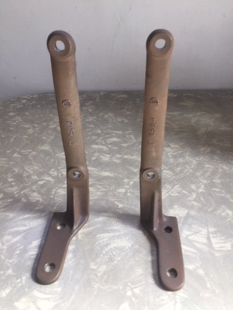

these are Torpedo brackets
