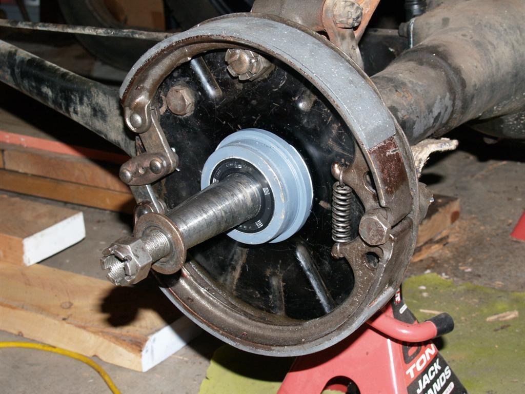

My outer wheel oil seal, but this is made up of steel (used what we had):
Only way to stop the leak....
