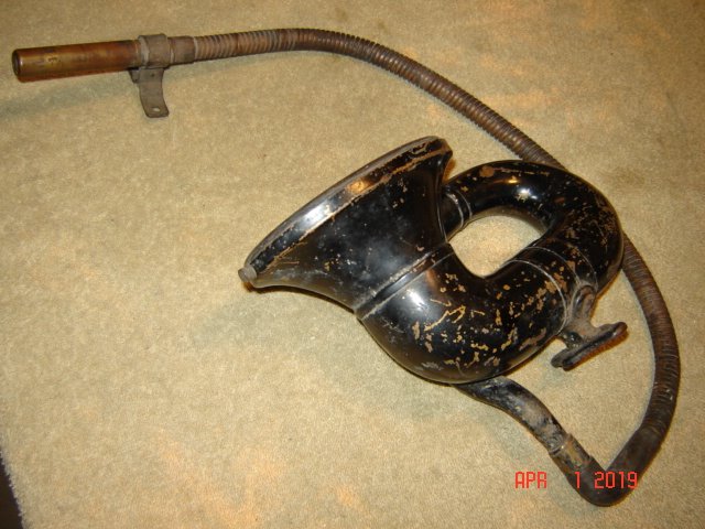

Does anybody have any factory drawings or specifications for this typed of horn bulb bracket?
I have repaired and rebuilt this one a couple of times now:
With the flat bar steel and a single screw, it looks like it would be an easy part to make.
I could make some guesses and make a part that looks good, but I would like to replicate it as close as possible.
If anybody has one and would share some measurements, I would appreciate it.

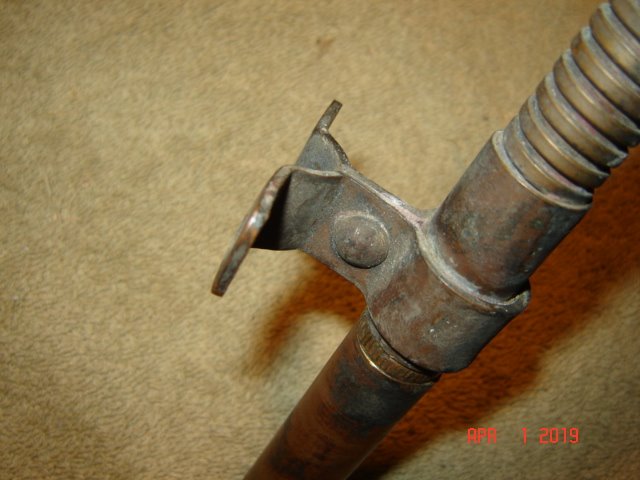

These are photos of an original 1915 horn setup that I have. The horn bulb bracket and the rivet are brass on this one , that was made by STANDARD. With 3 or 4 suppliers to Ford in 1915, some may be brass and some may be steel.
The brass stock that was used to make this bracket is 5/8" wide by about .085 thick. If you anneal the brass it may be easier to form. and solders well.

Jim-
Thank you! This is what I am looking for. Please would you tell me:
You said the material is 5/8" wide. What is the width of the mount?
What is the measurement center to center on the holes? hole size?
What is the length of the flat part where the rivet is? about 5/8"?
What is the radius or diameter of the curve? Looks about the size of around the pipe?
Those repro brackets from the vendors are a joke!

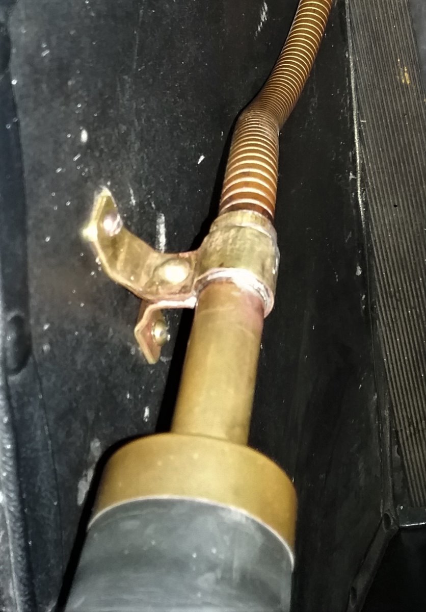

Than you for all the help and support.
Thanks, RV.
My horn set up is not stock, but it looks a whole lot better and is much more secure than what was there before.
Again, thanks to a lot of people.
Keith
Thanks, RV.
