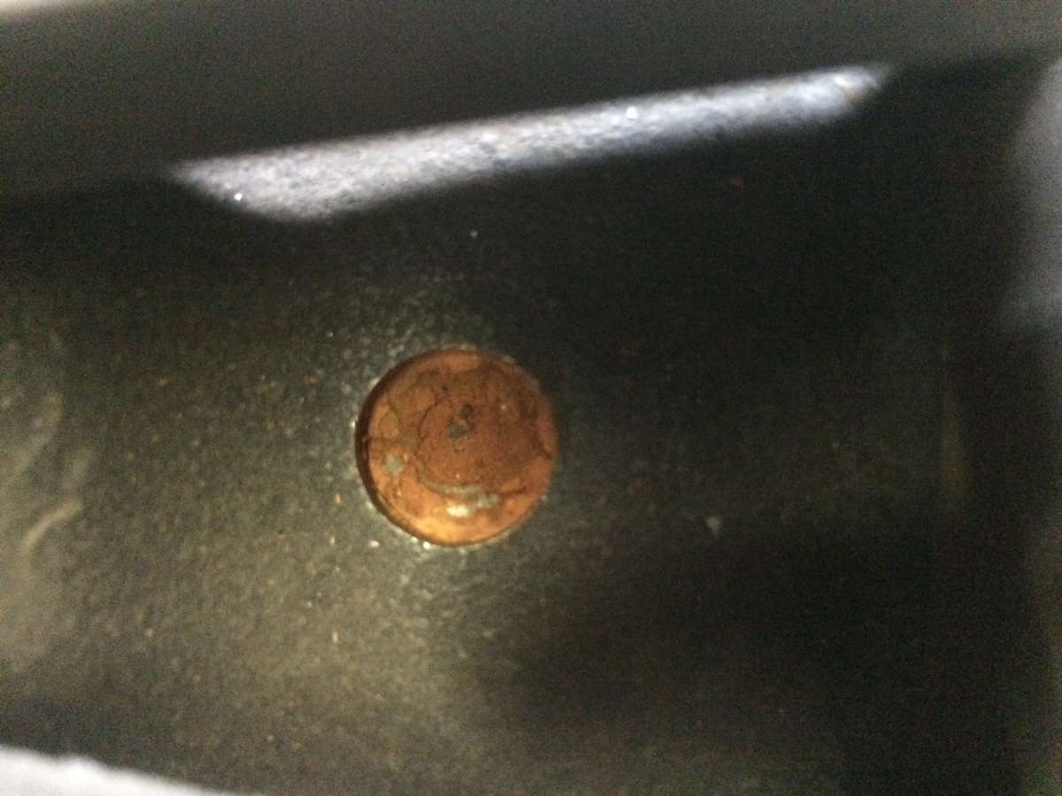

- Posts: 1359
- First Name: Les
- Last Name: Schubert
- Location: Calgary
Re: Balancing transmission drums in VA
[image][/image]
I see this one was pretty good. Only required a bit of help on the magnet side

In regards to drums, it looks like I’ve been lucky (which I will take any day)!! Maybe Ford Canada drums were made better. Certainly no guarantee of that!!

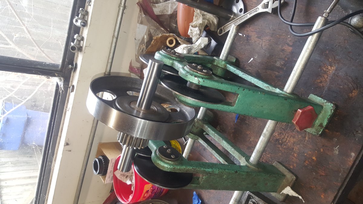

- Posts: 1152
- Last Name: Gould
- Location: Folsom, CA
I am balancing transmission drums today and tomorrow. I have a static balancer, the type with rwo sets of wheels on two triangular stands and two mandrels I made. The low speed drum was 11 grams out, the slow speed 12 grams. Getting is perfect is a neverending battle, but the two are better than 2 grams out so far. I'll probably try to get it closer tomorrow, but it seems once you get one heavy side balanced, another pops up in a different place. I'll get it as close as I can without going bonkers.
- Posts: 5438
The above looks like a new drum which I am thinking might be a different story then original drums. I would think removing any material from an original drum might be dicey, after all they are already 93+ years old. New drums would be nice, but for some of us, that isn't in the cards.
Now I am not saying not to, but to think about it first.
- Posts: 1070
- Last Name: Warren
- Location: Henderson, Nevada
Hi Scott, This was a 1926 engine for my father. The balance is pretty good, but could have been better. Fourth main only ran out .0015 and aligned perfectly with the pan. Just saying that the drums appear to be the culprit and I wouldn't take a chance again.
- Posts: 1152
- Last Name: Gould
The drum pictured above is an original drum which has been trued and polished. I've never had a problem balancing original drums. Re the low speed and reverse drums I did today, it was a matter of enlarging the holes. The brake drum/diving plate assembly is different of course, but I don't anticipate a problem.

For the speed range the cars I work on I use the knife edge for the flywheels. I have found the cast type need more work done then the later (1926-27 ish) fully turned type.
Richard thanks for the correction on the drum in the photo.
