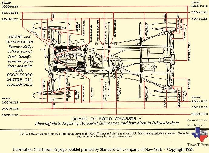

http://dauntlessgeezer.com/DG103.html

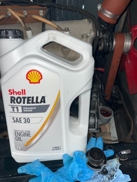

Just changed the oil for the upcoming FL Winter T Tour, a gal. jug of of good grade oil , Wallymart @ $16.00.
