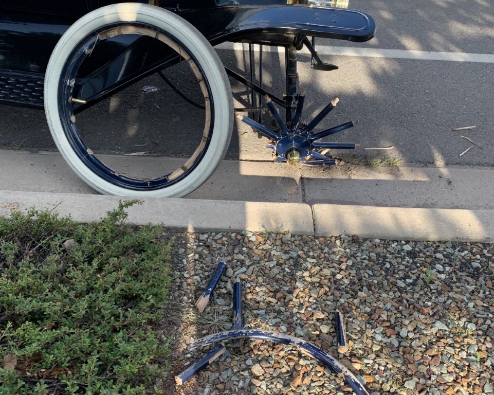

Ben, Please have your wood felloe wheels rebuilt. Here are a couple of photos of what happened to an original wheel that had a loose felloe. The restorer (not me) screwed the felloe to the rim along with the rivets. The wood was original and looked good, but was filled with wood filler to make the wheel smooth. Upon making a slow left turn, the wheel exploded. After taking all of the wood from every wheel, I observed that the previous owner had made the wheels look good, but had not made them safe. The four wheels on this car have been sent to Noah Stutzman for rewooding. I urge you to have your wheels redone by a reputable wheelwright. I highly recommend Stutzman's Wheel Shop in Baltic, OH. Your safety is worth MUCH more than the cost of four rewooded wheels!!! I hope this helps. Russ Furstnow

Noah was working on the rim of a non-demountable when I picked up my 3 wheels for the Fordor and the steering wheel for the Torpedo. Could very well have been yours Russ! Gosh what excellent work! Anyway, he must've had like 25 rims for Ts all around the shop ...that tells a lot about his work! So Ben, yes, again, take our advice...send 'em in. Russ just verified what I said about front wheels especially taking "a beating" upon turns. Most of us really have no idea just how much lateral stress is on those things on a turn, and well, how many "faster and/or sharp turns" do people even make, eh? I try to make them slow and "wide" just to keep the stress level down. Maybe I'm paranoid or even wrong, but at least it makes me feel a bit more safe, and of course with new spokes it's even better. I think the non-demountabes from Noah are actually less than the $300 that was previously stated. Minus shipping of course!!

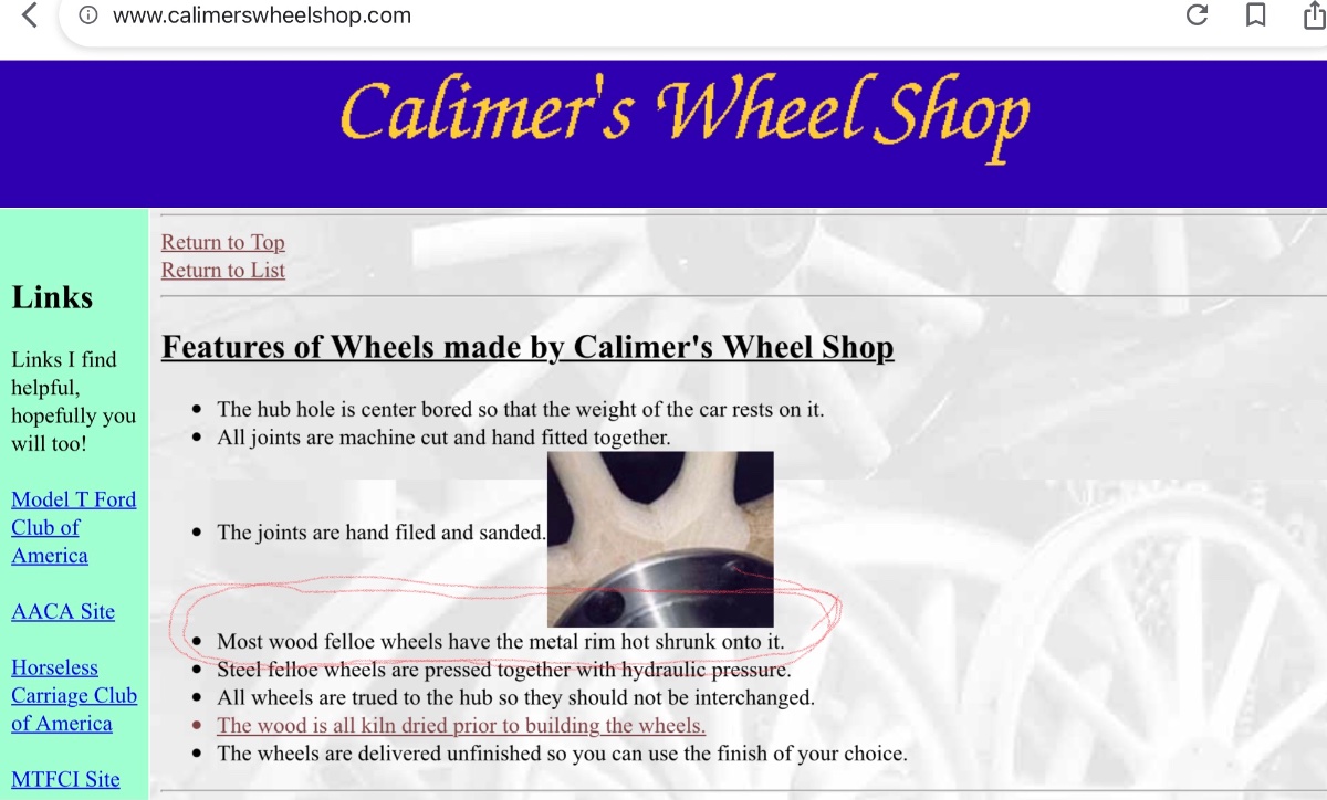

That rim is heated and shrunk onto the felloe
That is the better method, shrink the rim to the felloe, then rivet for added security. Having Calimer’s do a set of 30 x 3 fronts for me now, pickup in Luray.
