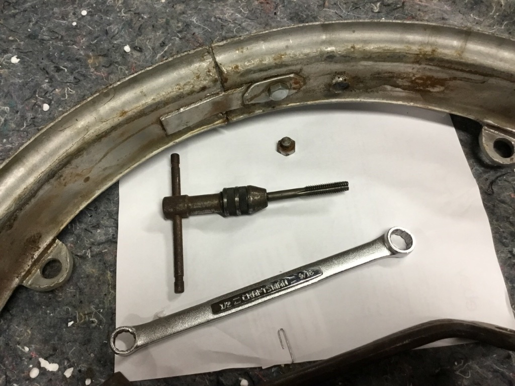

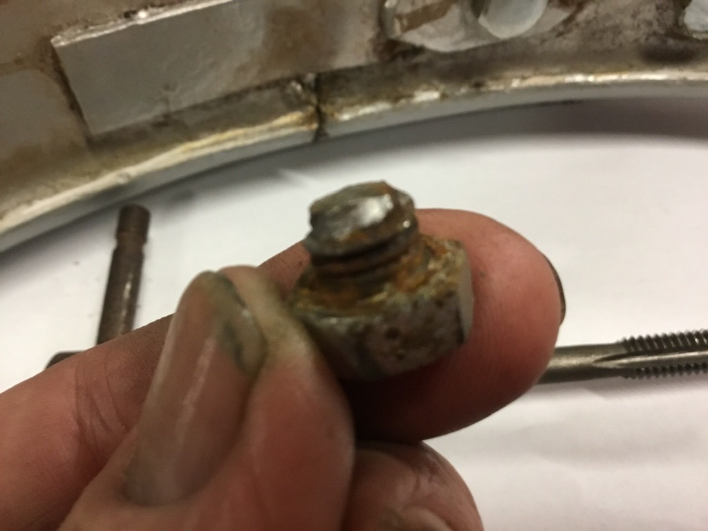

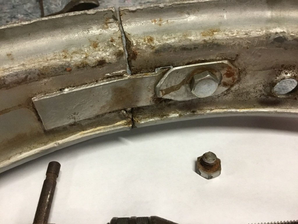

Jerry. The revolving lock latch was held in place by a 3/8”-16 bolt, cut off from behind. I tried to loosen the bolt so I coyldturn the latch and it twisted off. It would not go back in, so I redrilled the hole and tapped it with a 3/8”-16 tap, screwed in a new bolt and cut it off and rounded it off. The rim is still very strong and substantial and no, so is the lock. Jim Patrick

Looks good! I kind of think those bolts where originally rivets, but no matter, your repair looks good. BTW, the latch plate is supposed to rotate without the need to remove or loosen the bolt/rivet. Usually, a hammer and punch to swing the latch plate 90 degrees, allows the tongue to disengage.

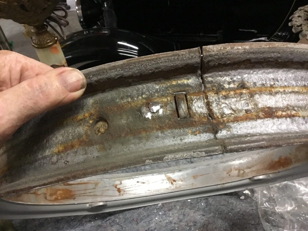

My rim is barely distorting and still round as I try and force the bead on. The non-locking side has only moved a half inch beyond the end of the lock side and the rim is still very round and is still in contact with the opposing end. Am I supposed to force the non-lock side out of round in order get the tire on? I have gotten it halfway on, but have reached the point to where I cannot get the tire iron under the bead. Seems like I have seen split rims with the non-lock side much further in than mine, but I am reluctant to force it too much out of round. Jim Patrick

you can safely slide the latch side over the non latch side to the point where the latch tang touches the tube stem without permanently deforming the rim. I usually wire the two adjacent lugs to hold it in that position before I begin to mount the tire jb

The latch lever you show also I do not think is original. Never seen one quite like it. Also, it looks good, functions well, and should be fine.

Jim, I think you are going to have a problem with that latch and bolt, I would suggest replacing it with a correct latch and hold it in place with a rivet. The rim is not thick enough to hold a bolt. I have seen split rims that used a bolt to lock the latch, but if I remember there was a boss on the rim that gave it more thickness. The attached picture is what your latch should look like.

Thank you Jeff. That 3/8” bolt holding the original latch is not original, but is a 60 year old repair to the the low profile rivet that broke off many years ago. The head of the bolt I replaced the broken one with is the same height as the old bolt head and it mounted onto the spoked hub just fine, however, if, for some reason the bolt head will prevent the rim from fitting onto the spoked hub, I can lower the profile of the bolt head by grinding it down to a rivet sized profile, using an angle grinder. As it is, I will probably need to take off the bolt and latch, so the split rim will open up to the stem hole. Without doing that, I believe the bolt head will stop the split rim from opening up as much as it needs to. If I need to repair the other rims the same way, I will use Stainless steel 3/8”-16 bolts. Jim Patrick
