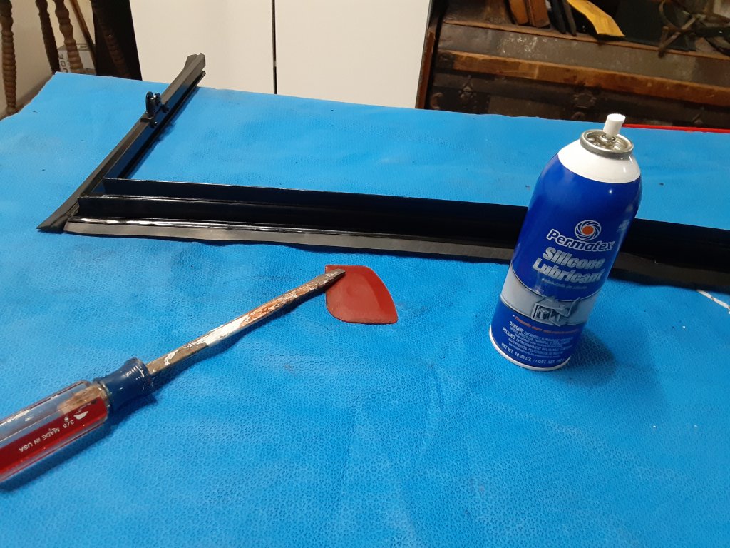

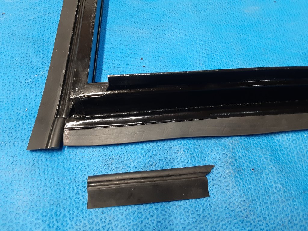

I need help installing the windshield frame rubber gasket for my 1927 coupe. The attached photos will help in explaining the situation. It is going to be difficult to insert the gasket into the small grooves.
What lubricant should I use? I would appreciate learning what others have done to install it.

Here is what I did to get the rubber seal into the windshield frame, after painting.
First, I lubed the bottom piece with soap and water and pulled with pliers, couldn't get it in.
Second, I lubed it with baby powder (corn starch--talc not available), couldn't get it in.
Third try, lubed it with silicone, couldn't get it in.
Fourth try, spread the channel with a screw driver (used a plastic pad to protect the paint) and added more silicone, couldn't it in. I used a twisting motion with the screw driver.
Fifth try, spread it some more, got it in with a lot of hard pulling with the pliers.
To install the two side pieces, I spread the channel with the screw driver and pushed it in without any lubricate. I then used a hammer and small diameter rod to tighten the channel.
