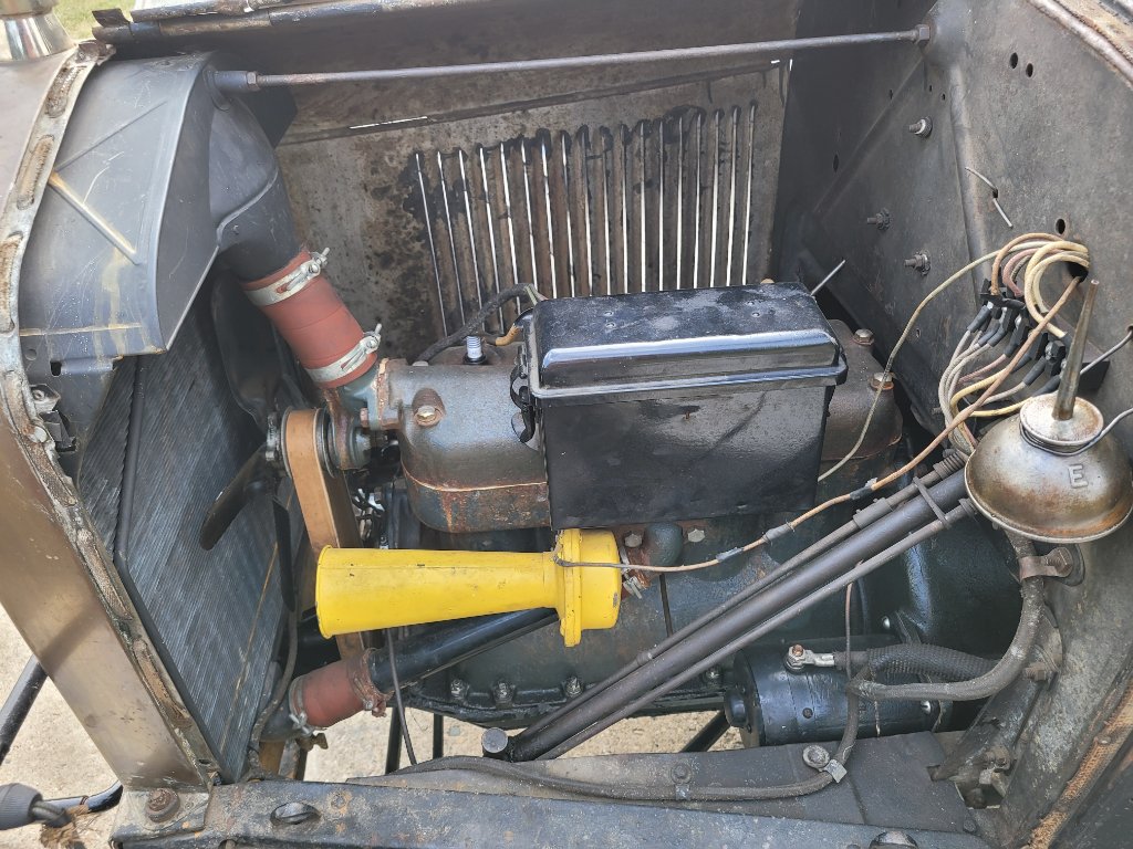

Some people over the years have asked me about the yellow horn. All I can say is dad liked the horn yellow as it matched the yellow of the wood wheels that were on the car for years. If I can find it I have a very old photo of the car as it looked when dad first brought it home. It was sitting on wire wheels that dad incorrectly thought were from a Model A, thus the change back to wires for the car. I'll be posting photos as we go along.

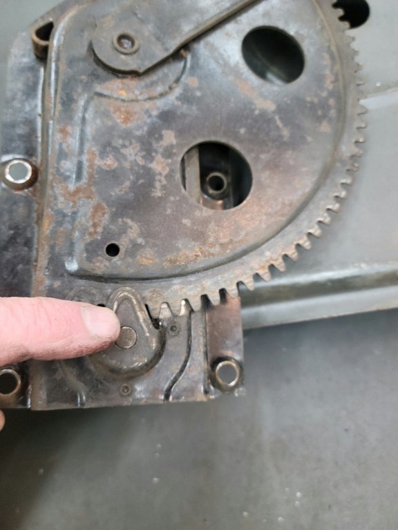

I got the innards of the door apart tonight. After 50 years I figured out what was wrong with the window mechanism. The part of the regulator where my finger is pointing allowed the gear to slip off and the crank no longer worked. A couple firm hits with my ball peen hammer and the mechanism works like new.
On another topic, one can clearly see this was a Budd built body.

When regulators "go off the track" as yours has, the cause is often that the car was left outside in inclement winter weather and snow and ice got inside the door and froze. Instead of waiting for warmer weather or moving the car to an above-freezing location, someone strongarms the window handle.

I have no doubt you are right...in fact I remember the day my mom did it...and my dad was passed. Keep in mind this was a 28 year old car my dad bought out of a junkyard. It was abused.

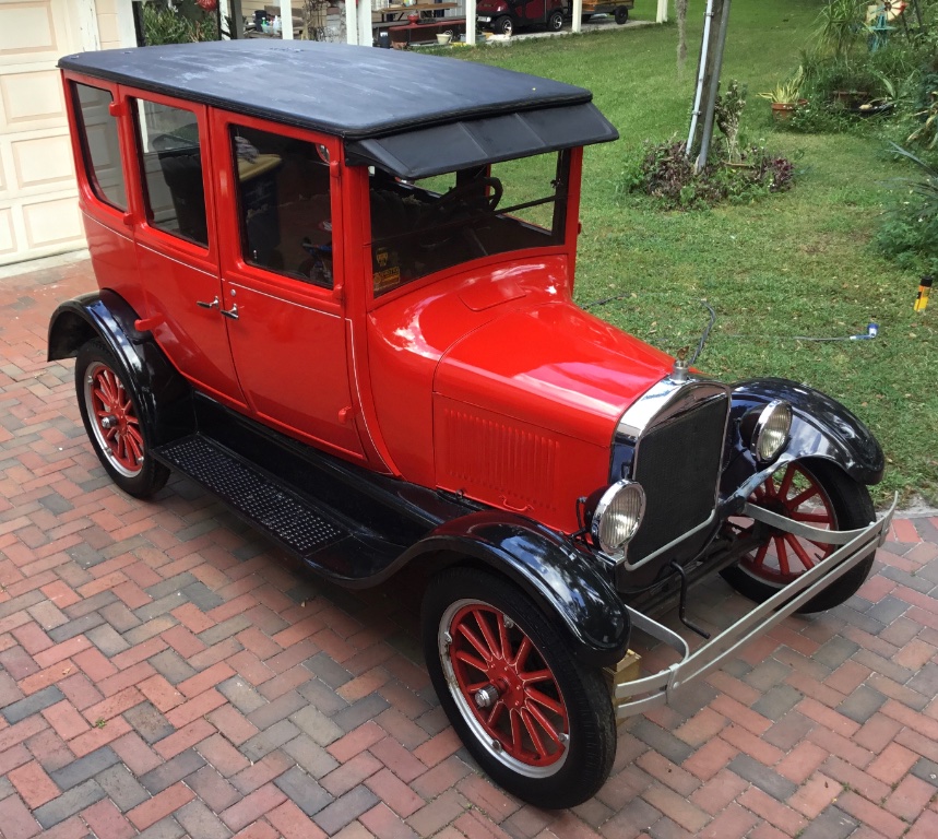

Are you going to get a proper sun visor for it? The one that is on there may have been on it when your Dad bought it, but the correct one is a frame of metal covered with vinyl and sewed around the openings. I have pictures of an original sunvisor on a factory original Fordor if you need me to send them. Jim Patrick
