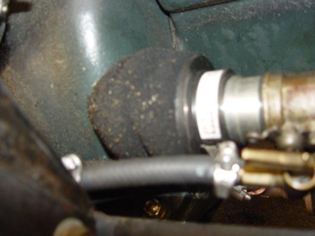

So, why don'tmy lawn mower filters restrict the flow to my T carbs? In fairness one is a Stromberg 97, not a NH, but still on a T, same filter, and no problem.Scott_conger wrote: ↑Sat Apr 06, 2019 11:57 amTomIf you don't use a filter, get ready to rebuild carbs!
based on your above quote, with respect to T carbs, I would suggest that you don't know, what you don't know. That's OK...not everyone knows about T carbs, but your statement with respect to Model T's is simply inaccurate.
It is excellent that your T's run so well with filters...that proves that your sediment bulb and screen are performing as designed, and that you don't need a filter. Filters are notorious for restricting fuel flow in gravity fed systems.
I recently helped a guy get his '18 started. There was about a 1/2 " of crap built up in the bowl of the carb.
Don't all modern engines have fuel filters? Why? I know my lawn mower and generator do.
So what is it about the T carburetor that it doesn't benefit from a filter preventing crap from the gas tank getting into it?
If your filter is restricting flow, you need a new filter and be glad whatever was blocking your filter did not get to your carburetor.
Please, another expert besides Mr. Conger, explain to me why a model T should not have a filter in the fuel line?
Or even Mr. Conger, what is it I don't know that I don't know about Model T carbs?

Tom, I'd hazard the reason is because you (fortunately) don't have a problem with "crap" in your fuel tank, and you indicated that you change out the filters in regular maintenance. When an in-line filter collects enough "stuff" in a gravity system, flow will be restricted. I've only been reading on these boards for a couple of years, yet in that time, many posts have been made hoping to diagnose problems with poor running or non-starting Ts, where the cause has been found to be an inline fuel filter. In most cases, the filter wasn't immeditely identified as the culprit, as fuel still flowed through the line - just not enough to provide adequate fuel pressure under load, the resulting stuttering, missing or quitting often mimicking ignition woes. As the old saying goes, 99% of carburetion problems are electrical, and vice-versa.
The stock system, i.e., the "spud" sediment bulb under the tank, with a fine screen over the outlet has proven adequate since inception to keep "crap" out of the carb without restricting flow. It is true it's nowhere nearly as refined as modern filters, hence the "stuff" you found in the carb bowl of the '18. The cure for that is the drain cock on the carb bowl.

Actually, no, none of my T's have sediment bulbs. Why should they? Two of my T's have gas tanks that have been cleans and sealed, where will sediment come from. The speedster has a plastic tank, it should not have any sediment either. I could get some dirt in the tank when filling at the station, or from using a gas can, but no problems so far.Scott_conger wrote: ↑Sat Apr 06, 2019 11:57 amTomIf you don't use a filter, get ready to rebuild carbs!
Keeping the fuel system clean is pretty basic, starting with a clean and sealed tank helps. If your tank is dirty or corroding on the inside you are asking for problems. And they will eventually manifest themselves in the carburetor, a very mysterious device that very few understand. Many don't even know what they don't know...
Look at these pictures Ester, grab your pearls, where's my nitro???

If it works fine, it's a small point, but the large end of the filter goes toward the carb, not the tank.

You mean the end which is white on the left side in the picture goes to the carburetor? That is how I have it.Scott_conger wrote: ↑Sat Apr 06, 2019 3:08 pmIf it works fine, it's a small point, but the large end of the filter goes toward the carb, not the tank.
