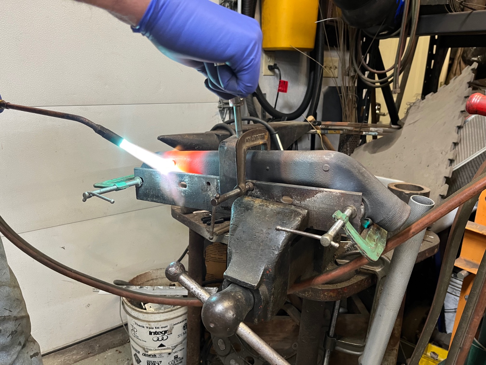

Did not know they could be this bad. Should have measured it before I tried to install it. Would have saved on the frustration. My only spare doesn't have any threads left. I have seen where some have teased them back with heat, but I am not sure I'm up for the challenge.

Seen worse, up to 5/8" on that rear port. Yours looks about 1/4". Thats straightenable with a reasonable success rate.
The tooling or fixturing, prep, plus gas are not worth it for a one time need. A new one is the smarter play. If the threads are good, ists worth $5-10 to a guy that straightens them @ a swapmeet.

A manifold warped ¼" or more is likely to crack, though I've been told that can be avoided by partial straightening, letting it sit a day, then final straightening. I haven't tried that yet. In my experience most manifolds warped less than a quarter inch have survived straightening.
A new manifold costs $84 plus shipping. I spent about $45 making a straightening jig. Do I use up $39 worth of gas per straightening? No, not even close to that. But did I use up $39 worth of my time making the jig? Yep. :)

Post by Petrah Phyre » Sun Mar 20, 2022 5:46 pm
Almost clicked 'order' and then though, what would it hurt to try. I know not everyone has a piece of 1" plate lying around, but that, two c-clamps and a turbo weed burner took me in the right direction. I kept it good and hot and slowly turned the clamp at the center. I did back it off a time or two to make sure I was not just pushing a hole through the top. All looks like it came into alignment. I am now "cooling" it in front of a space heater. It is a tad chilly here, so wanted to slow the process. I dont have a bucket of dry sand or I would have went that route. Now to just pray that things stay put and I will have saved a few pennies.

Good on you. I also do some of my best work when I have nothing to loose. I am a bit surprised your simple jig does the job. Every bit as good as my purpose built manifold jig.

The jig your showing works great! The one I used was one I copied from one of the T club sites and took a a little more to build than yours.
Looks like using a good straight piece of flat stock or maybe a length of angle iron works well with the C clamps. Just using something from the scrap pile and some c clamps does the trick!
Does your turbo weed burner use propane or?

Post by Petrah Phyre » Sun Mar 20, 2022 6:40 pm
Tim, those are the gaskets I have on hand.
John, propane.
It is cool now and does still have a slight deflection. No twisting though. We will see if it is close enough that it wants to sit where it is supposed to.

Post by Petrah Phyre » Sun Mar 20, 2022 7:57 pm
Succes. Mounted up nicely. I know, I know. The parts aren't correct, but for now, they hold things together. This is a patch, get it running for a quick jaunt. Full rebuilt will take place in the future.

I have straightened many of them, I use a breaker bar and socket, heat the manifold and let the weight of the wrench move it, it you force it they will break, if bent really bad like 3/8 of inch I would heat it a couple different times, do not try it all in one heat or they will break, if you let them cool down over night I have had better luck at it. Just my two cents on it!

How hot do you heat them? RED?
I probably have 4 or 5 to do
Posts: 7392
Re: Warped exhaust manifold.
Post by Steve Jelf » Sun Mar 20, 2022 10:16 pm
Beyond red. Orange to yellow, wherever the wrench starts to fall.

Les as Steve said as hot as it takes for the wrench to fall on it's own, be careful when they are that hot it is not much more then they become two pieces.

Mark: The 'falling wrench' method and associated fixture are shown here: http://mtfctulsa.com/Tech/manifold.htm
Petrah Phyre: Thanks for sharing your uncomplicated approach to straighten the manifold. jb

Caveat: I have never straightened a manifold. Not with heat, not with any method.
The point I have always pondered is that every warped manifold I've come across, it is the rearmost and ONLY the rearmost exhaust port which is out of line. If this is the case, then why is it that every picture I've ever seen of straightening the manifold concentrates heat to a very small portion of the manifold where the manifold is NOT bent. Yes, it works, but concentrating the entire straightening stress on a very small area seems like it is the culprit in cracking that often occurs. Would it not make more sense to heat the ACTUAL area that is bent, and spread the stress across a much larger area? You lose a little bit of leverage at the wrench, but you'd be straightening what was actually bent, and as mentioned above, would be spreading the movement/stress across a larger area. It might take more gas to heat a larger area, but I'd bet that the risk of cracking would drop off considerably.

Scott: I agree. It takes a much larger flame to heat the larger area but as Petrah clearly demonstrated it works. The quick heat it white hot in a dine size spot, not so good.

If parts are easy to find,a new 1 is nice to have.
BUT if you do try the heat and dropping wrench method,do it exactly as explained and it does work. I made the mistake of touching the wrench on the last 1 I tried and it broke.
just a light touch,wasted the time.
So do it exactly as explained.

I did heat the entire manifold with my torch. Used to braze, cracked cast tractor manifolds back in farm power mechanics in high school. We would always throw them in the forge until good and hot before, and for a short time after. We then would bury them in dry sand to slow cool. Usually worked out fairly well. The farmers we were working for were a little tight on buying new parts. Most things had to be fabricated.
Eventually my manifold will be replaced with a header and this one will be saved for my wife's '25 frankenT she wants me to build. She wants a C cab PU on a car chassis...ok, what ever you want Dear. :D

That heat and repair plan does not work very often for a few reasons.
Once they are back in alignment, the space between the #2and #3 exhaust port has lengthened about 1/8th inch and the ports still don't fit.
The exhaust manifold cracks almost in two between the #2and #3 exhaust port the first time the engine overheats.
The crack is welded and soon cracks again.

My experience, and method, is a little different. The back port does appear to be the most out of line, probably due to it being super heated by the three in front as the gasses are expelled. However, careful attention will almost certainly reveal that there is a bend throughout the manifold, not just between the last two ports.
When checking, I place my straight edge focusing on the two centre ports. Almost invariably the front port will be dropped a bit, and the back one more so. Unless the bend in either port is greater than 3/16", the manifold can still be fitted, as is, and with gland rings to stop it bending further.
I make offset gland rings using exhaust pipe so there are no gaps like the rolled rings suppliers sell. The two centre ones are the standard length. I cut 4 extras for the front and rear ports. From the straight edge reading of the manifold bend, a pair of rings is set up with an offset to mimic the amount of bend indicated. These two are welded together on the inside, making a solid gland ring. The same process for the second out-of-line port.
The bent manifold will be slightly shorter than optimal due to the bend. This too, as well as the bend, can be compensated for by slightly rotating the offset glands when fitting the manifold. I fit the glands into the manifold and check the fit to the block, rotating the offset glands as is indicated. The whole can then be fitted with the copper rings as is the usual practice. I always use a heat proof manifold sealant, to help hold things in place, and to provide a sound seal at each port.
I did this initially because new manifold were not available. I still do it to save original manifolds which have good threads, to save the not inconsiderable cost of a new manifold and the shipping costs and the delays, and to have a correct looking manifold on an earlier car.

I had a bunch of warped manifolds, so I started playing with them and a rosebud torch...
The first one I tried to straighten in one fell swoop... fell it did, as it broke. Darn.
Checked the next one - no cracks... Heated it slower, again, tried to straighten in one shot - pulled a crack. Darn again.
Then I tried something different - because the warp develops over decades of use with a uniformly hot manifold, and pulled down by the pressure of the exhaust pipe, I figured what if I tried kind of the same technique to un-warp them?
First I heated the entire manifold and let it cool slowly... thermal cycling and annealing the manifold under no pressure whatsoever (kind of like making a knife). I figured if there were any stress spots in the casting, this would help releive them.
Couple days later, I again heated it slowly to a uniform temp (hot but not glowing) in my gas forge. Once evenly hot, I used the rosebud to increase the heat to the area I wanted to straighten (ID'd by soapstone marks), and applied fairly light pressure to see if I could get it to start pulling the warp out on its own, BUT - I limited the downward motion to maybe a few millimeters total. Once it had moved, I pulled it, and repeated the thermal cycling. Let it cool, then repeated the procedure.
It took a lot of in and out (and fuel gas), and a lot of time, but all in all, the manifold was eventually straightened, no cracks, no pings. I did a second one (a later one with both longitudinal and radial warpage), probably took a month of effort to get it worked out, but again, it ended up straight, flush, and aligned to the holes in my test block...
My thought was these aren't made warped, but develop the warp over decades of a similar thermal cycling, developing hots spots, and having the exhaust system pull them down... so repeating the same thermal cycle and hot spot with pressure in the correct direction (and pins to brace it where it needed not to be "fixed") seemed to reverse the damage of time, loose or ineffective clamps, and exhaust pipes. Of course, buying new repops is both cheaper and faster, byt YMMV... if nothing else, it was a fun experiment.

Post by Rod » Sat Mar 22, 2025 1:30 pm
I had two exhaust manifolds that were straightened today by Kenny Edmondson. Here are the pictures.
