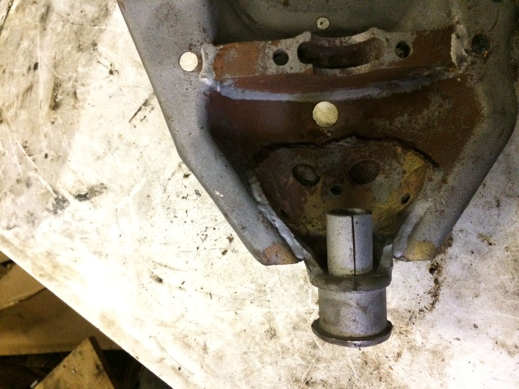

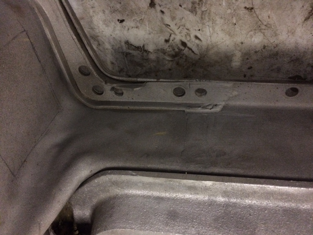

Re: Model ‘A’ and ‘B’ crank shortening for ‘T’ & Related Questions
Hank
On the “block shift “ I shorten the front of the pan by relocating the front support from the outside to the inside of the nose. Yes the fan gets a bit closer to the radiator, but the hogshead stays in the stock location. I can post pictures.
Hank
Pan pictures
Pan pictures
