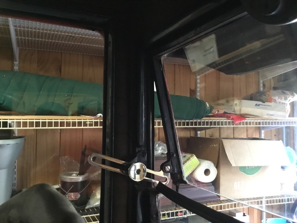

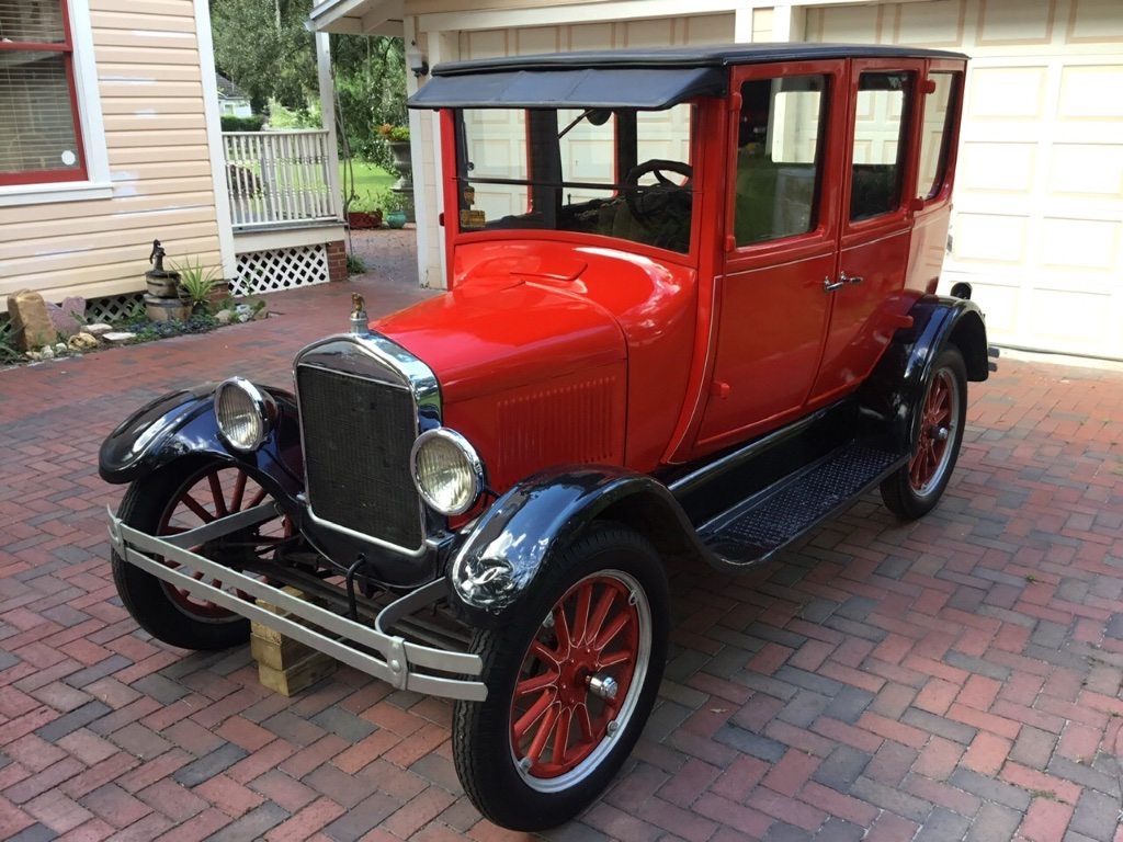

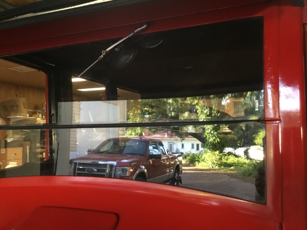

Here are pictures of the 1926 Fordor split windshield. Nothing like the 1926 win shields on the other closed car styles. Jim Patrick

Thanks for posting the pictures. Nice looking T. I see that the windshield is curved on the lower portion. Do you have measurements of the top portion? Would the top portion be the same for 25-25 and 26-27?

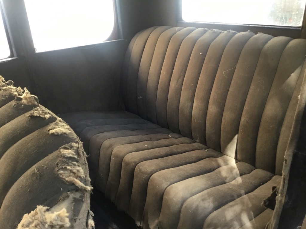

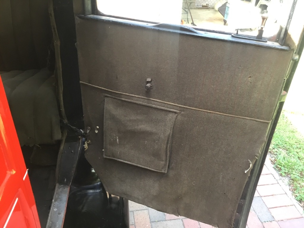

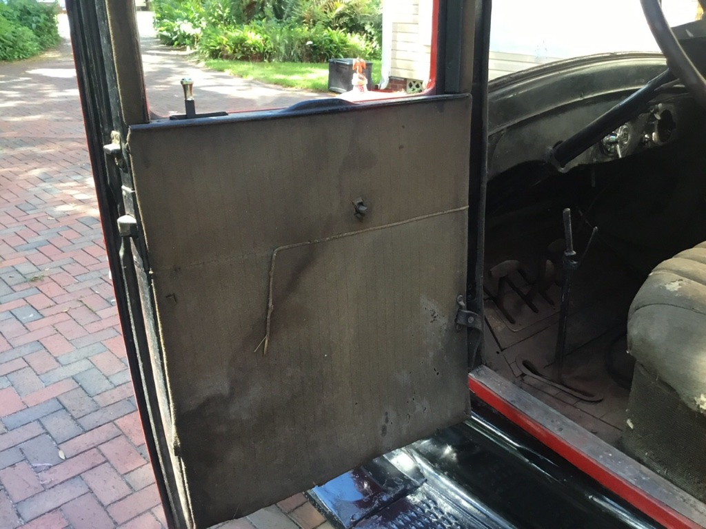

Could you also post pictures of the seats as well?

The top portion of the 26-27 closed cars is wider. The 24-25 closed car is different in that both halves of the windshield are the same. The 26-27 closed car windshields are totally different.

I sold this Model T last month for $8,500.00. New owner lives in Texas and is due to pick it up at the end of April. Here are pictures of the seats. Jim Patrick

Top windshield from R frame edge to L frame edge is 38 3/4”. From inside frame at top to bottom edge of glass is 9 3/4”. I do not know how far the glass goes up into the frame channel. Jim Patrick
