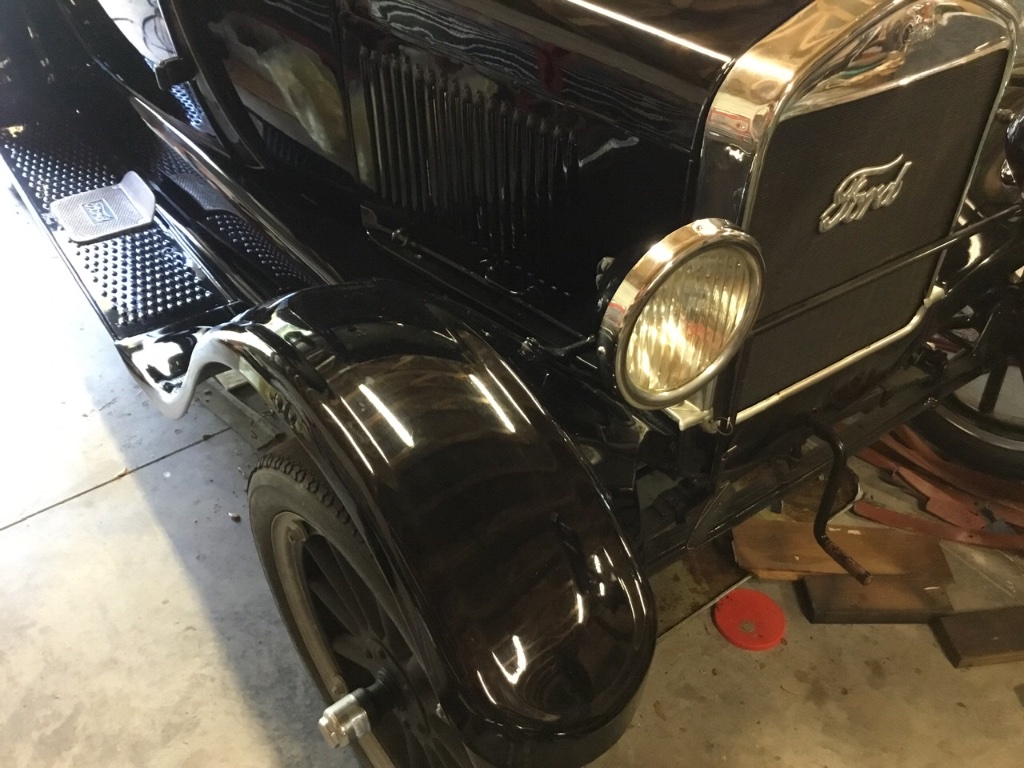

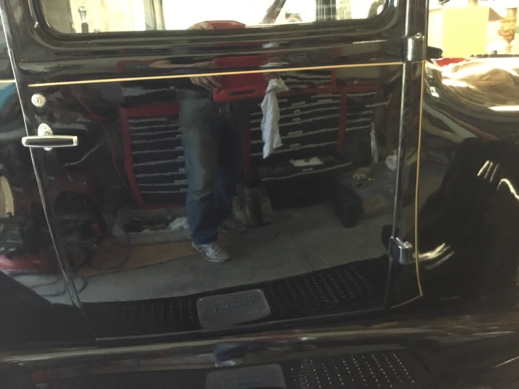

I decided to not remove any dents or other blemishes. I sensed that was what a number of the responders would have done.
I used Jim Patrick's recommended Meguiar's polish to hand clean the outside surfaces and Turtle Wax heavy duty rubbing compound for the interior surfaces, followed by the Meguiar's polish.
I liked the results as shown in the attached photos. Sorry, several had to be rotated to get them attached.
