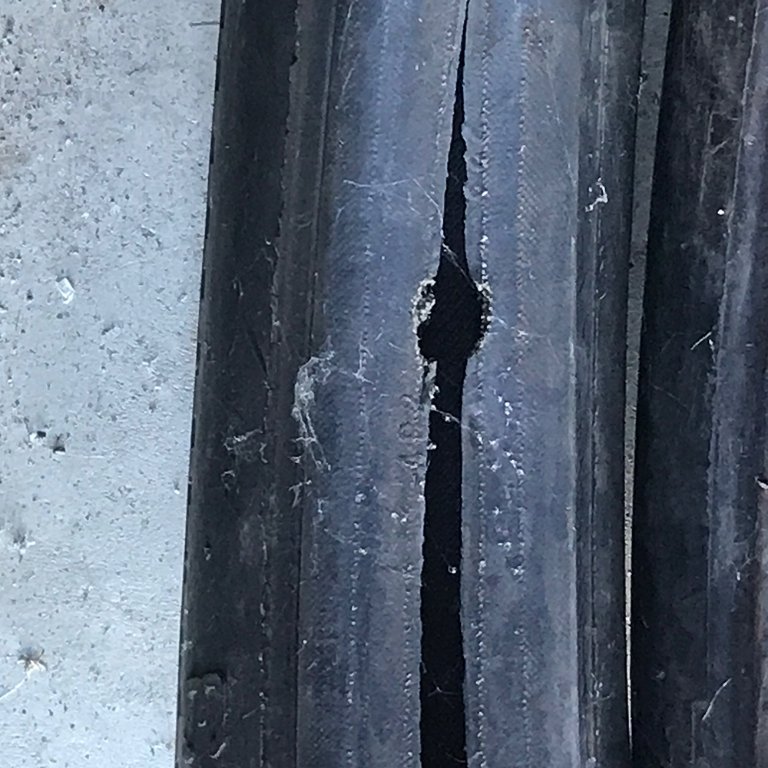

Steve is a master of replacing rubber stems with original brass... Me, not so lucky. I've tried it with mixed results. To expand on what I was saying about the clincher tire cutting rubber stems, one solution exemplified by the attached photo of a 50 year old tire shows what they used to do "back in the day". I followed the old-timer's example and ground some relief in my tires after having two stems fail from side cuts. After doing so I didn't have any more flat tires but the rubber stems still made me nervous.
Since going to brass stems, no problems of any kind. The Blockley tubes I got are of such high quality I expect to be able to use them with the next set of tires I have to buy, making them very cost-effective in my book.
- Posts: 4961
Re: Hartford tubes
Thats not enough of a stem relief cut.
Will work with a metal stem, but must be much larger to not rub & pinch a rubber stem.
- Posts: 6922
Re: Hartford tubes
I have yet to see any modern recreation of a beaded edge tyre upon which the two beads go anywhere near each other when fitted to a T rim. Even our old Olympics with the wider foot did not need relieving. If the rim is measured, and the beads on the tyre measured, I'd be interested in the gap between the two. This observation is made by one with absolutely no experience of the narrow 3" wheels used on the front of early USA T's.
I have seen Olympic tyres with the valve stem reliefs, but I suspect they are cut to aid in getting the valve stem down the hole when fitting tyres one side at a time.
Others will disagree, and period photos will show the reliefs, and those old time tyres may have needed them, but not the skinny gutted rubbish we have to deal with.
