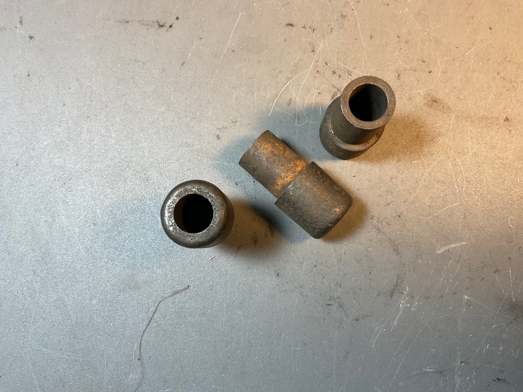

NOS Ford replacement T push rod guides look like this:
Respectfully submitted,
Trent Boggess

Great info and photos. Thanks.
Trent do you know if the lifter guides in the block are part of the block casting or are they separate pieces thar can be pressed out. If not then the block must be bored to accept the replacement guides, correct?
Much of my experience is with 09, 10 early 11 blocks with the removable guides.

Part of casting, must be bored out.
Any machine shop that can install valve guides can install lifter guides. Should even have a modern guide to do the job. Dan

1909 to early 1911 open valve engines used replaceable brass push rod guides.
