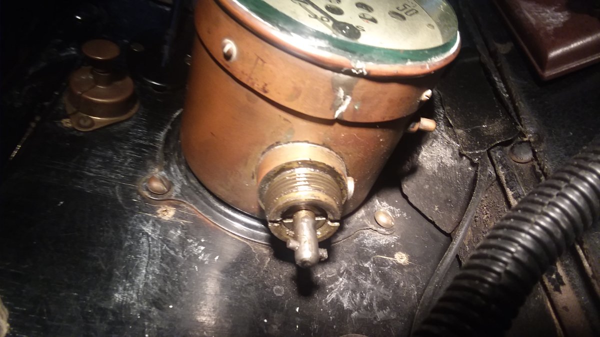

In the meantime,
Pictures (I hope) of the receiving end of the Speedo...
Thanks again Kim,
More later

Kim= long slender end picture attached. if you have a replacement, let me know details
Cable (wound spring) is 55" end to end.
I will try attaching other pictures.'
