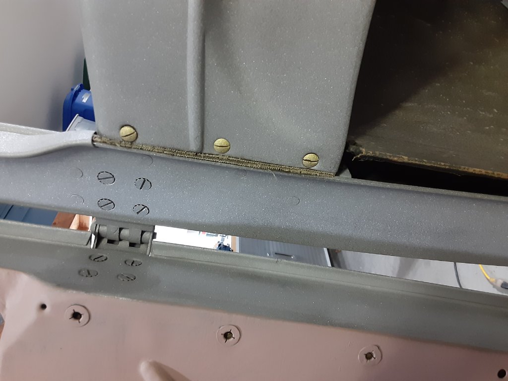

Sorry that I was not clearer in my question!! I meant the fiber material between the dash and the door column.

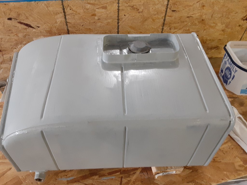

Even tho the inside of the tank is spotless... be sure to inspect the external front panel of the tank for deep rust pits. There was a tar paper anti squeak pad between the tank and firewall that was notorious for holding water and causing rust.
Also, be careful not to tighten the mounting straps any tighter than necessary, as the solder joints will be stressed and develop cracks.

I do not know what that fiber material was made out of originally. I believe it was just for looks and to reduce/prevent squeaking. If you need to replace it, a piece of an old leather belt should work. Otherwise, if it's in relatively good condition, I wouldn't mess with it unless I absolutely needed to. Let sleeping dogs lie.

Or you could put windlace in it like what belongs there. There is nothing exotic about it, nor is it rare. If the correct interior is purchased, it should come with it.
If it was my car, I'd be removing all of the sheet metal parts around it, removing every bit of old interior, and replace things properly after painting.

Kevin, I was fortunate the back of the tank, which was up against the card board piece, was in good shape as shown in the attached photo.
Alan, I did not have to do any cleaning inside other than rinse it with gas and a little oil mixed in. I was surprise on the inside condition being that the tank had not been used in 62 years!

While your tank is out, check the best you can for loose baffles. 26/7 cars are bad for drumming noise made from loose tank baffles.
- Posts: 4729
Re: What Goes Here?
What do you do if they are loose? Whats the fix?Jim Eubanks wrote: ↑Thu Apr 28, 2022 5:19 pmWhile your tank is out, check the best you can for loose baffles. 26/7 cars are bad for drumming noise made from loose tank baffles.
