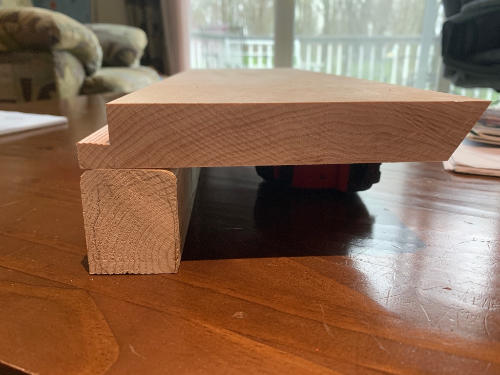

Ok so I’m mocking up my pieces for my Delivery car project so I can work ahead. I’m trying to get some ideas of how the sill runners are attached to the floor pieces. The sill runner is 1 1/2”wide and my main floor runners are 6 1/2” wide x 1” thick. The floor runners run the entire length from the back of the car to the firewall. The floor runners have a rabbet on each side that is 9/16 x 1/2” to receive the 9/16” floor boards. So how should I attach the sill runner to the floor runner. I thought about screws in the rabbet through the sill runner or screws through the top of the floor runner. Combination of both?  Also should I use any glue as well? Thanks

I can suggest methods, but if I wanted to do it right, I’d call a guy in st charles, Illinois and head there with a good camera.  He has the only surviving complete one, and another he rebuilt from remnants. Otherwise, just educated guesses and opinions, at least from me.      One thing though, NEVER use glue on a wood body.

If I was just building it, I’d probably hide screws ( at least their heads) in the rabbet. Just a guess, though.

I think you’re suggestion might be a winner. I placed some #9 1 1/4 screws in it. I accidentally went a little too far down in my countersink holes. The only thing I don’t like is where that screw is in location to the sill runners. I marked on the sill runner on the left side where that screw location is to where I’d like to see it on the sill runner with a mark on the right side. I may run a few on the inside of the rabbet with a few alternating between them on the top of the floor runner. And no I won’t be using Phillip’s head screws

On my Martin Parry wood cab , they were not trying to hide screws. The holding power was too inmportant.  It looks to me that you may have 1/4 to 1/8 inch of wood under that countersink screw in your photo.  I agree your pencil mark in the center of your runner is the best place. I also agree with Tim ( no glue). When you get to the body, the mortis joints should be tight and only have one screw in the center. More than that, the joint cannot flex and will probably split the wood at the screws. I look forward to watching your project. I like the wood bodies.
