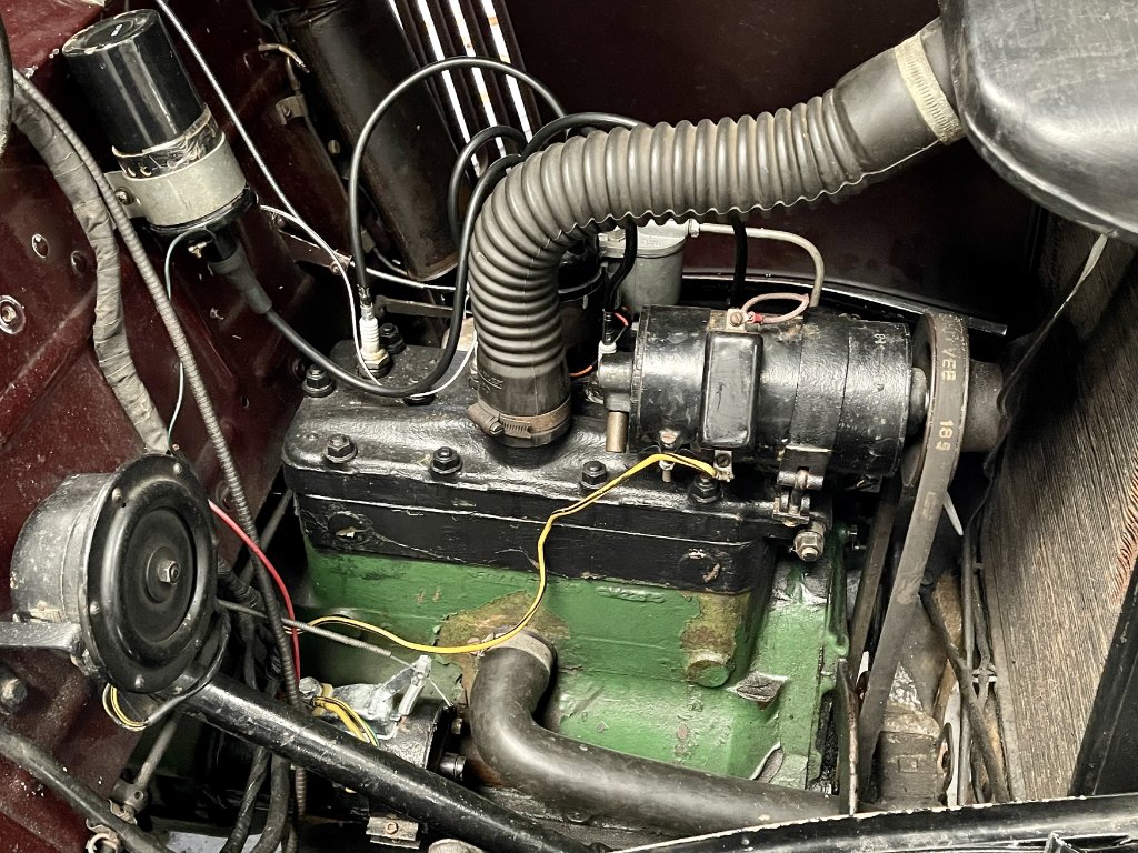

And then I will claim, that the Model A is a waterpump assisted termosyphon system. The pump helps cirkulate the water in the enginehead more than it pumps the water out of the engine to the radiator.
Finally - Ford did not drop the termosyphon system. In 1932 Ford introduced the Ford Model Y in London which had a 933 ccm termosyphon cooled engine. It was joined in 1935 by the Ford model C which had the same engine just bored up to 1172 ccm. That 1172ccm engine was almost unchanged used up to the 1960's. The last years in Germany (Ford Taunus 12M) it was with a waterpump because current styling prevented the high radiator needed for the termosyphon to work.
Ford Model Y engine bay - no waterpump

Interesting info on the Model Y and Model C! Nice to see the Thermosyphon had more life. The knowledge base of this group is impressive and deep.

Ford Model "Y"
Holy Cow! 8HP side valve engine and sold for about 100 Sterling...the things you learn here. This was a totally new one on me!

I wonder if a Y will fit in a T?
